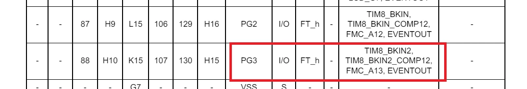

Hello Team,
Can we configure the port PG3 pin no 88 of STM32H743ZIT6 as an LCD_R0.
Looking forward for your response on this.

    Not possible as this alternate function is not available on that pin:
    Please refer to the DS12110 rev 10 page 77.

    Data Sheet tables should be definitive as to whether this is mappable or not.
