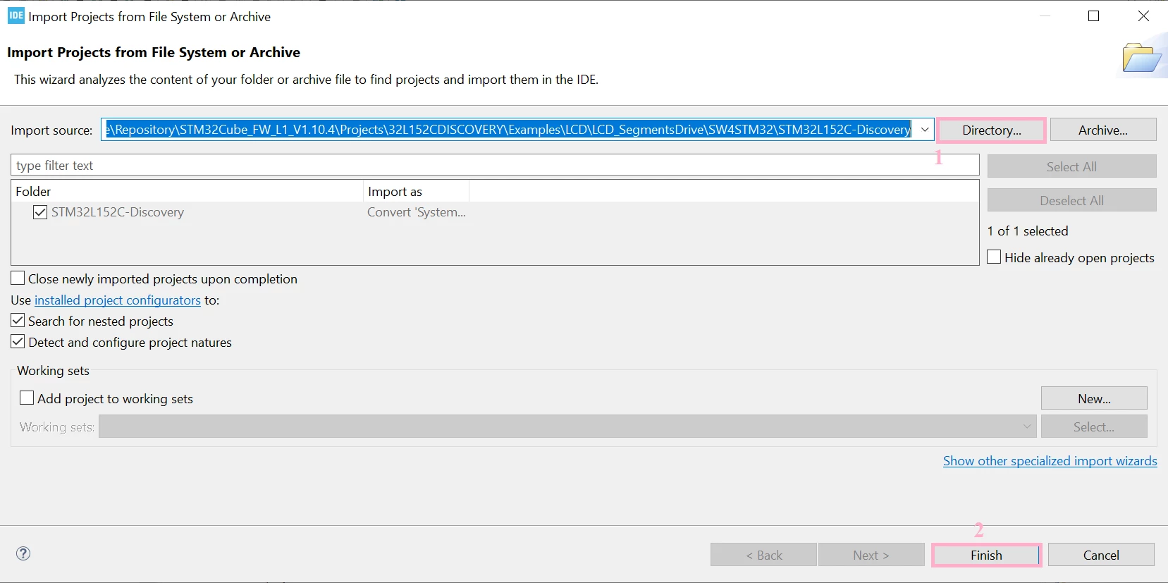

    Please follow these steps to open this example in STM32CubeIDE,
    1- Open STM32CubeIDE
    2-Click File-->open projects from file system or Archive
    3-Import project from the repository "...\Repository\STM32Cube_FW_L1_V1.10.4\Projects\32L152CDISCOVERY\Examples\LCD\LCD_SegmentsDrive\SW4STM32\STM32L152C-Discovery"  as shown in the below figure

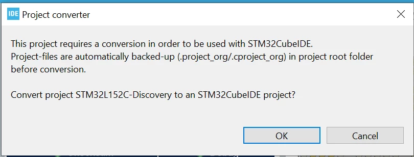

    4- Click to convert the project

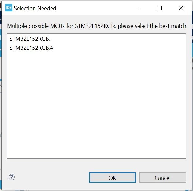

    5- Choose the device you are using

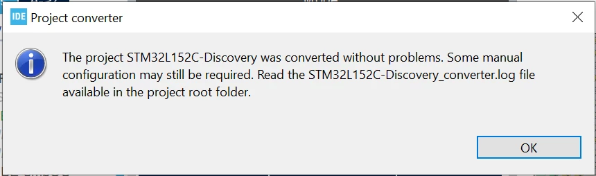

    6-Click "OK" to convert the project:
