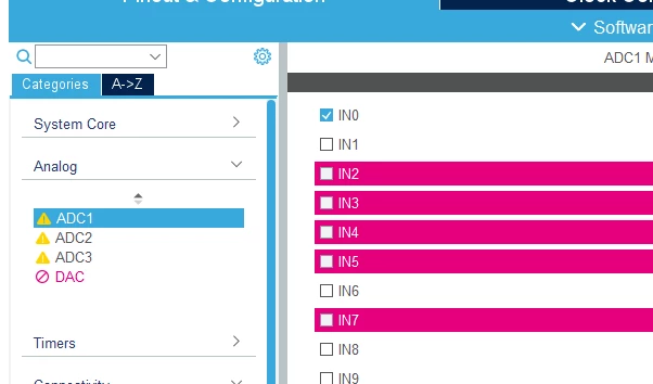

Target: NUCLEO-F446RE
I configured ADC1 on IN0, see image below:

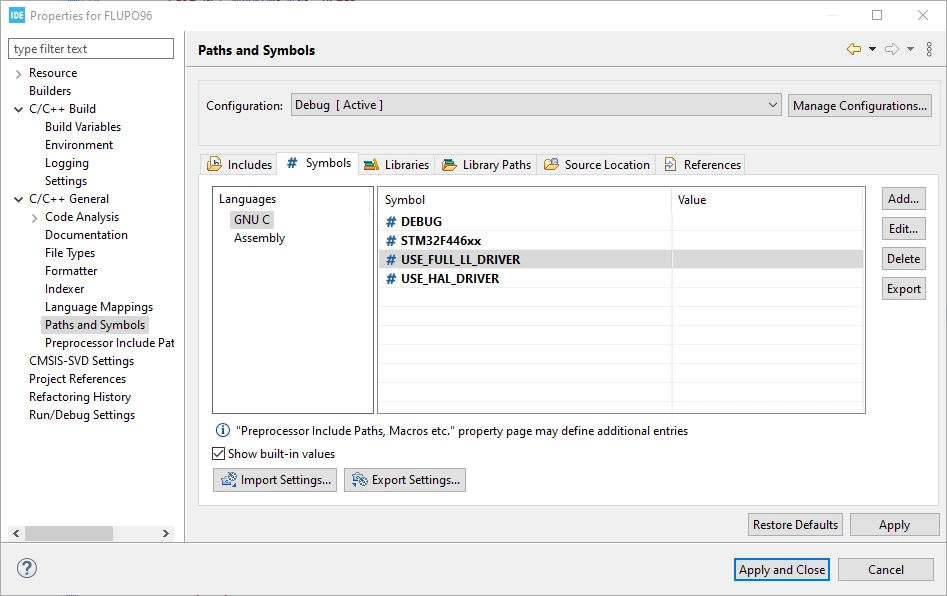

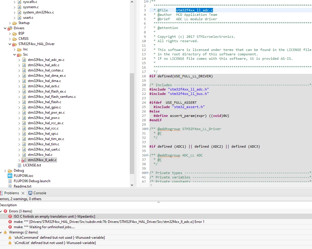

When compiling the project, file 'stm32f4xx_ll_adc.c' is 'empty' because all compiler directives are not fullfilled
1) what is file 'stm32f4xx_ll_adc.c' for?
2) is this behaviour a bug or a feature?
3) what to do?
