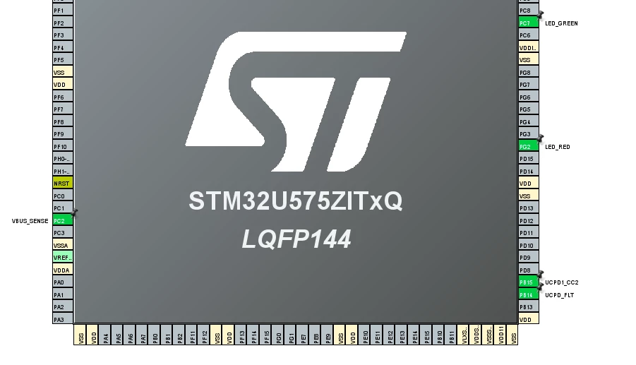

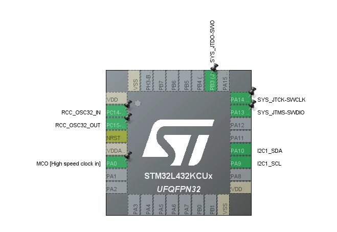

I now implementing i2c with 1 master (U575ZI-Q) and 3 slave (LK432KC).
I confirmed my code. It worked well.
but after changed title of the project and deleted some project, it made me confued,,
so I made every(1master 3slave) project new.
Here is the problem.
I think I forgot some MX configuration...
When I debug master, slave didn't receive data.
1. I use 4.7kohm external pull up resistor, so I set GPIO pullup/pulldown mode as no pull up and no pull down both master and slaves.
2. of course I changed NVIC I2C event interrupt enabled both master and slaves.

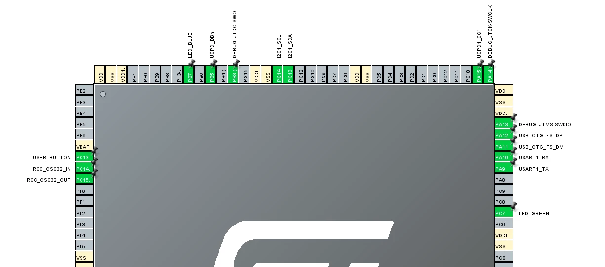

3. pinout view is like this
well.. I think master configuration could be the problem... but I'm not sure
I'll attach my master and slave main.c file
Thank you :)

    set all pin speed to low , to avoid ringing at xx MHz .
    And without debug : its working fine ?
    eunniAuthor
    May 3, 2024
    I think that's not critical reason for this error.. because It worked well before with very high output,,
    Also, I checked the signal with logic analyzer without debug (just run), it still doesn't work..
    Should I change GPIO pull up/pull down mode into "pull up" ??
    now I set both master and slave "no pull up and no pull down" mode...
    is it correct??
    AScha.3
    May 3, 2024
    I always set for I2C : pin speed : low ; pullups on .
    + For hi speed always need external pullups , but have internal on, is just some safety , if an external pullup has bad contact...run with low clock speed 100kHz or less, to test it.
    Otherwise : if 4k7 pullups connected, internal on (40k) or off doesn't matter.
