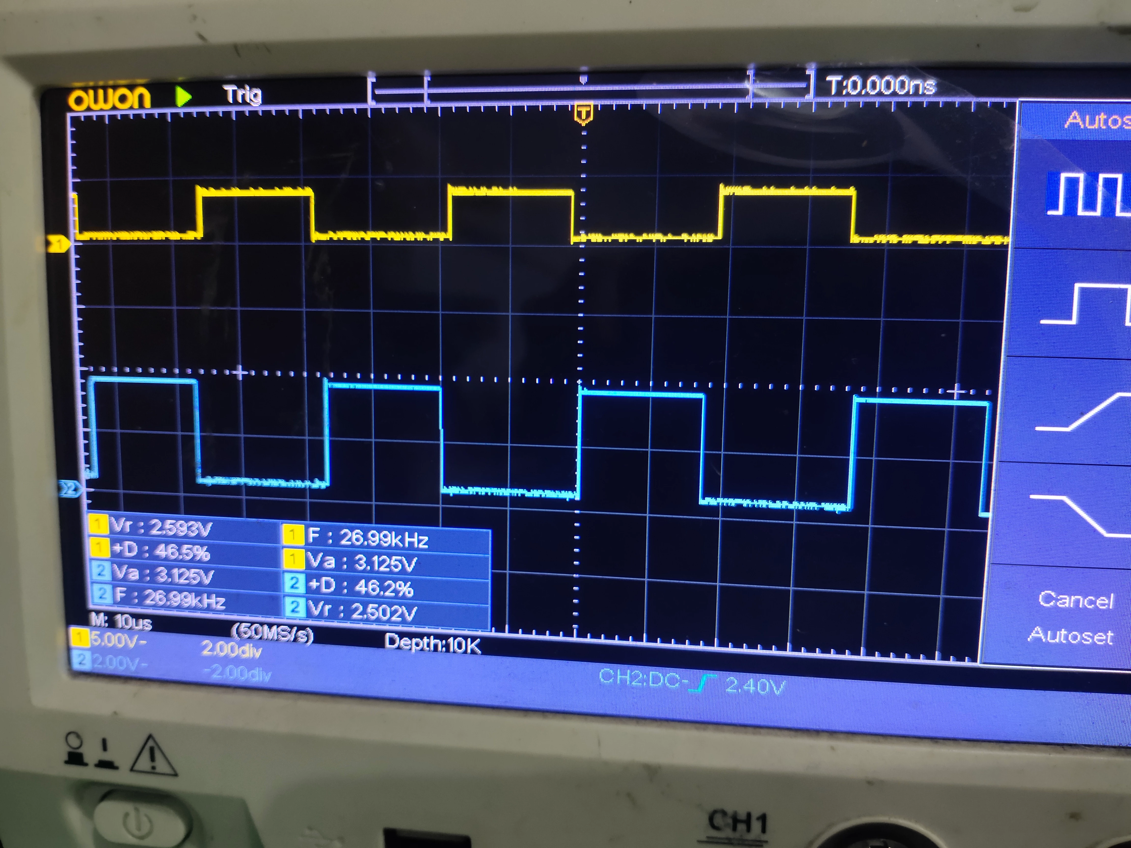

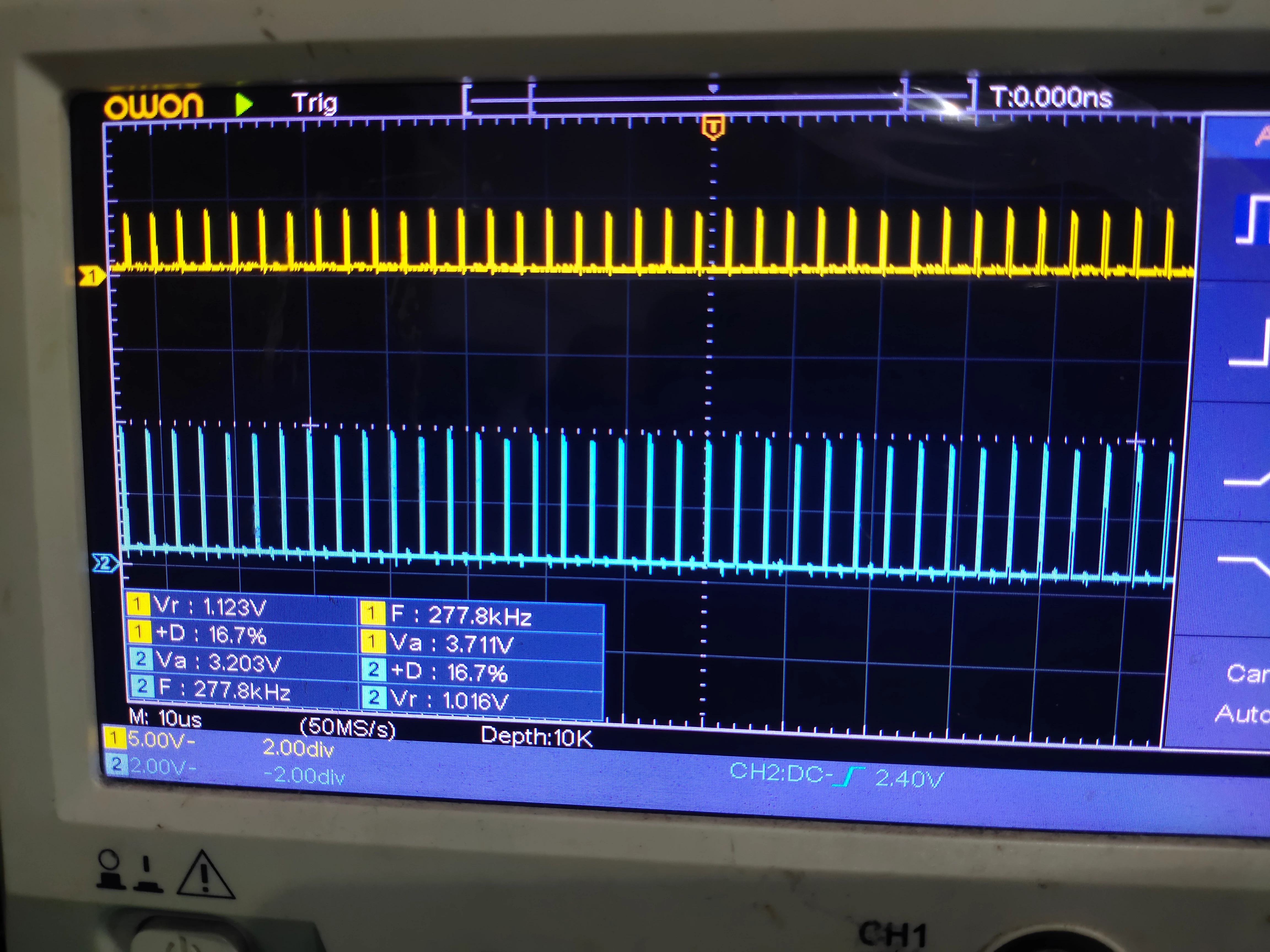

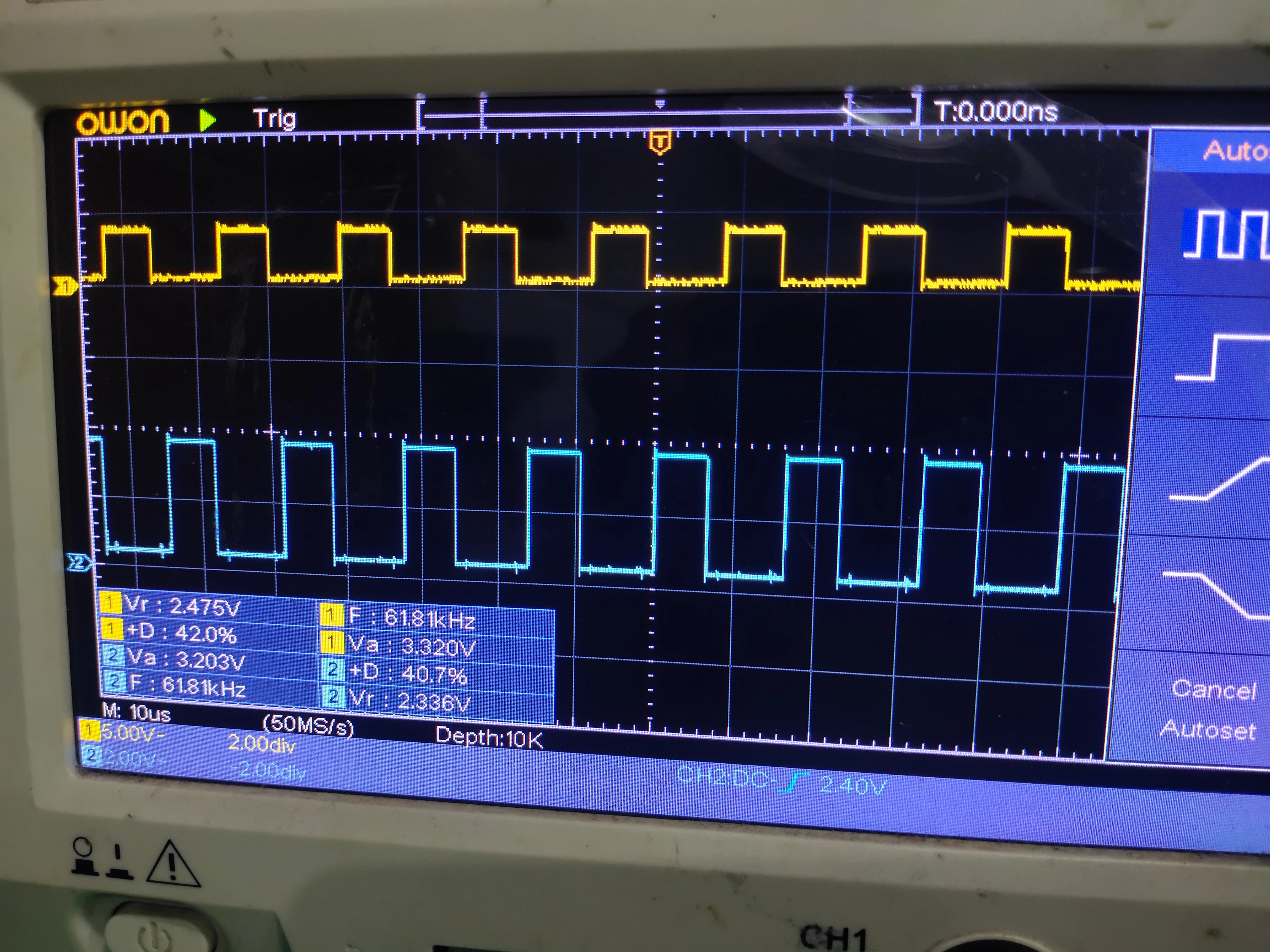

Complementary Pwm in STM32F103C6T6A
In complementary PWM out put my dead time increases or decreases when i am varying the Auto reload register value. is there a solution like 45% of duty cycle with one out put inverted and second output non inverted.
This is my HAL_INITS along with Timer Hal Start and Method to change the frequency and duty.

void pwmData(uint32_t dat){
 __HAL_TIM_SET_AUTORELOAD(&htim1,dat);
 __HAL_TIM_SET_COMPARE(&htim1, TIM_CHANNEL_1,dat/2);
 the change in frequency is ADC dependent.
    6 replies
    waclawek.jan
    October 4, 2023
    How do you observe that? Show screenshot/photo exhibiting this change.

    RChou.1
    RChou.1Author
    November 2, 2023
    sorry for being late to this reply,
    htim1.Init.CounterMode = TIM_COUNTERMODE_DOWN;
     any other configuration is not working thats why i used this.

    Also, changing ARR and CCRx in runtime while having
     htim1.Init.AutoReloadPreload = TIM_AUTORELOAD_PRELOAD_DISABLE;
    and also possibly CCRx preload disable, may lead to surprising results.

    RChou.1
    RChou.1Author
    November 3, 2023
    hello Mr  waclawek.jan
    first of all kindly see my attached file with this comment i hope it will help you to get the exact problem i wanted to explain you. I am Using a 22K pot for varraying the arr register value and you will be able to see here my duty changes too with change in frequency.
