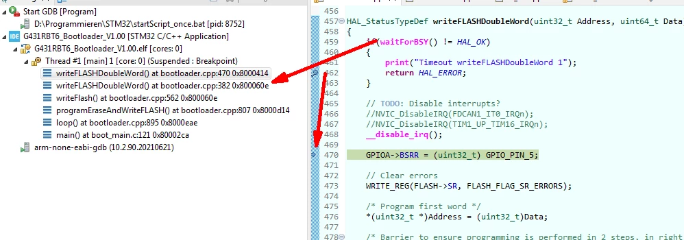

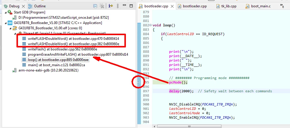

While trying to debug a problem, it seems that another one is giving me a hard time.
One function call is not shown, another has the wrong name ("writeFLASHDoubleWord" should be "waitForBusy").
The breakpoint is also missed.
Originally the code worked, but then i moved to the new prototype. I copied the project, and made a few minor changes. Mainly just the pins.
I had some hardfault before, which happend seemingly at "CLEAR_BIT(FLASH->CR, FLASH_CR_PG);" after writing FLASH. But after seeing the above, i doubt this!

When you see a "wrong" call trace, strange jumping through your code - my first thought would be: the memory is corrupted.
Any write operation, e.g. writing a buffer, writes to a wrong location, writes beyond the buffer size... Many reasons why to see a "strange" call trace:
  • the code is corrupted ("it jumps strange")
  • the stack is corrupted ("it does not come back from function call in the right way, e.g. registers restored are wrong")
  • the stack is too small ("a function called writes outside stack region")
  • you have not enable something needed ("the code assumes all is enabled and does not check for errors")
  • you malloc (head) region overflows ("malloc called without a check if successful and keep going with wrong pointer")
  • with the debug compile option: the code image contains additional (helper code and meta data) debug info:
    even this can be damaged (and wrong reports)
I would assume first (if debug trace looks "wrong" or "strange"): the memory content is corrupted.
When you say: "I had some hardfault before": have you fixed these issue? Or did they disappear just by adding more code? If so - the root cause is still there, just hidden and now hitting you again.
I assume, you have a bug somewhere in your code: check all writes, memory handling, memory sizes (e.g. heap for malloc, stack size), code writing to memory (buffers), all needed stuff enabled, if you handle "errors" properly (not ignoring issues, not to keep going when anything went wrong already)...
Happy debugging... do a code review.
