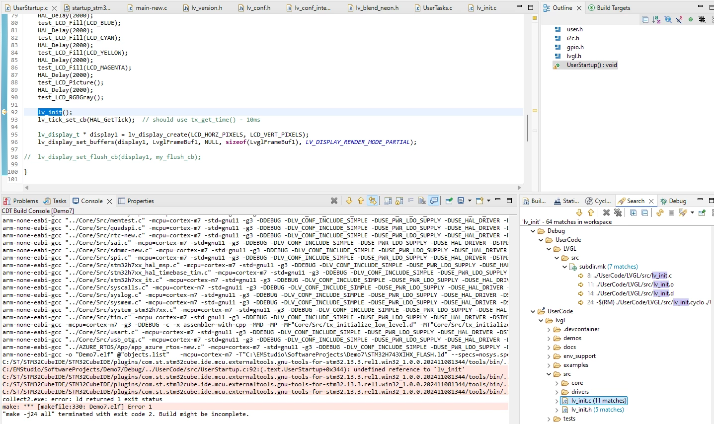

Compiler / Linker Broken in CubeIDE
The CubeIDE linker doesn't seem to work properly... Any help would be greatly appreciated.  ST Employee help?????
1- In the UserStartup.c, I call lv_init();
2- After compiling, it says it cannot find lv_init()

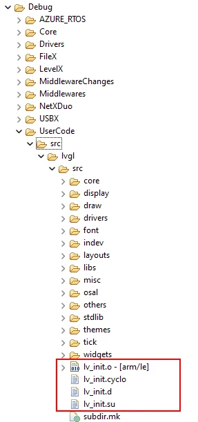

3- I see that the file lv_init.c file got compiled (lv_init() is defined in that file) - the object file was created lv_init.o
4- It seems the linker cannot find that file....
Is there a limitation on the number of files the linker can handle?

Hi @Pavel A.
I'd be really happy if the bug is between the chair and keyboard, but things seem to be pointing to the compiler.  Also, in the pre-compiler, there seems to be a problem with the includes.
In one file (early on in the compile), it has no problem finding the "#include "lvgl.h" file.  as the 6 min compilation continues, files compiled later with the same "#include lvgl.h"  generates and error: "Cannot find include file"
If I change the "#include "lvgl.h" to the real path, and not using the include search path, then the file compiles... To me this looks and sounds like a compiler limitation....
Also, there seems to be a limitation to the number of SRC directories defined in CubeIDE  (max 10).  Most were autogenerated by CubeMX.  I know this is a large compile and we are definitely pushing the limits of the IDE.

matt-crc
matt-crcAuthor
Senior III
Mar 28, 2025 12:22 AM UTC
@Andrew Neil
line 172
 * @file lv_init.c

Can you copy the full contents of the Console tab from a clean build into a text file and include it here?
matt-crc
matt-crcAuthor
Senior III
Mar 28, 2025 3:37 PM UTC
Hi @TDK
Funny that you suggested that... I've been trying to do that for days....  Unfortunately I can't figure out how to capture the entire console.  It scrolls past the console buffer size, so I can only get the bottom 1/3 of the project.  Is there a setting that increases the buffer size?  I see there were some warnings when compiling but I haven't been able to scroll back to see them.
BTW, I finally reduced the size of LVGL component by unconfiguring a lot of options and finally got a working executable.  I was going to run it this afternoon to see how it runs on the hardware.

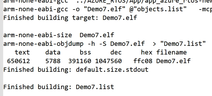

This is all that the console can capture
Mar 28, 2025 7:50 PM UTC
There are no errors in that log file and the ELF was successfully created.
Is this issue resolved?
matt-crc
matt-crcAuthor
Senior III
Mar 28, 2025 8:05 PM UTC
Hi @TDK
I always try to get it to work even with an open question... I resolved the issue by reducing the source file sizes and removing a lot of code with #ifdefs.   The full project still cannot compile, and I will send the complete project to your ticketing system later tonight.
