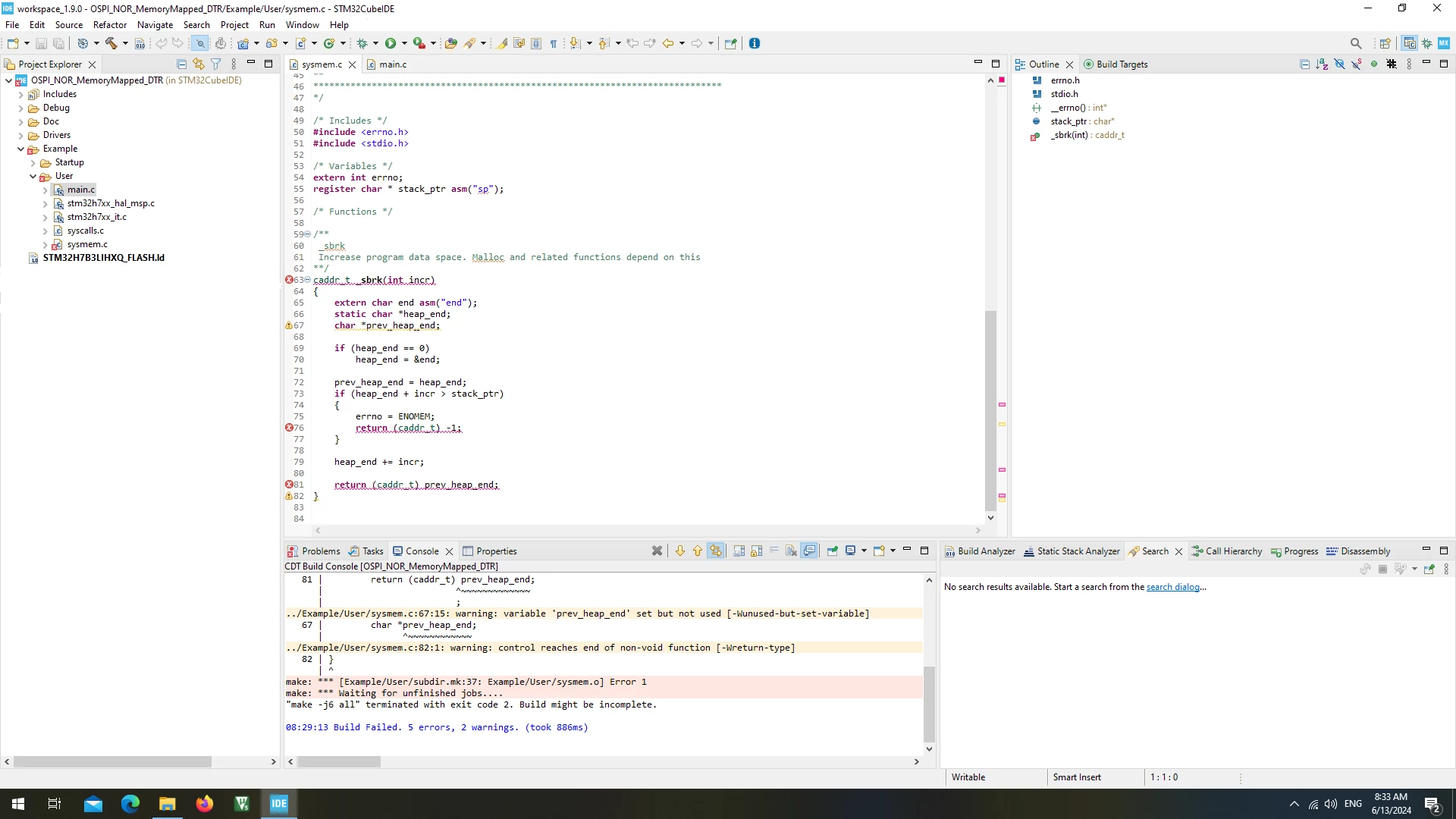

compile errors in STM32Cube_FW_H7_V1.9.0, anybody from STM to comment ?

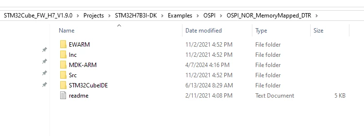

Every project in this folder for OSPI in H7 chips using CubeIDE compiles with error, Keil complies without errors

Hello @MNapi ,
Yes this is something that has been corrected since release V1.11.0 of the STM32Cube_FW_H7.
You can find the latest versions of the FW package here.
