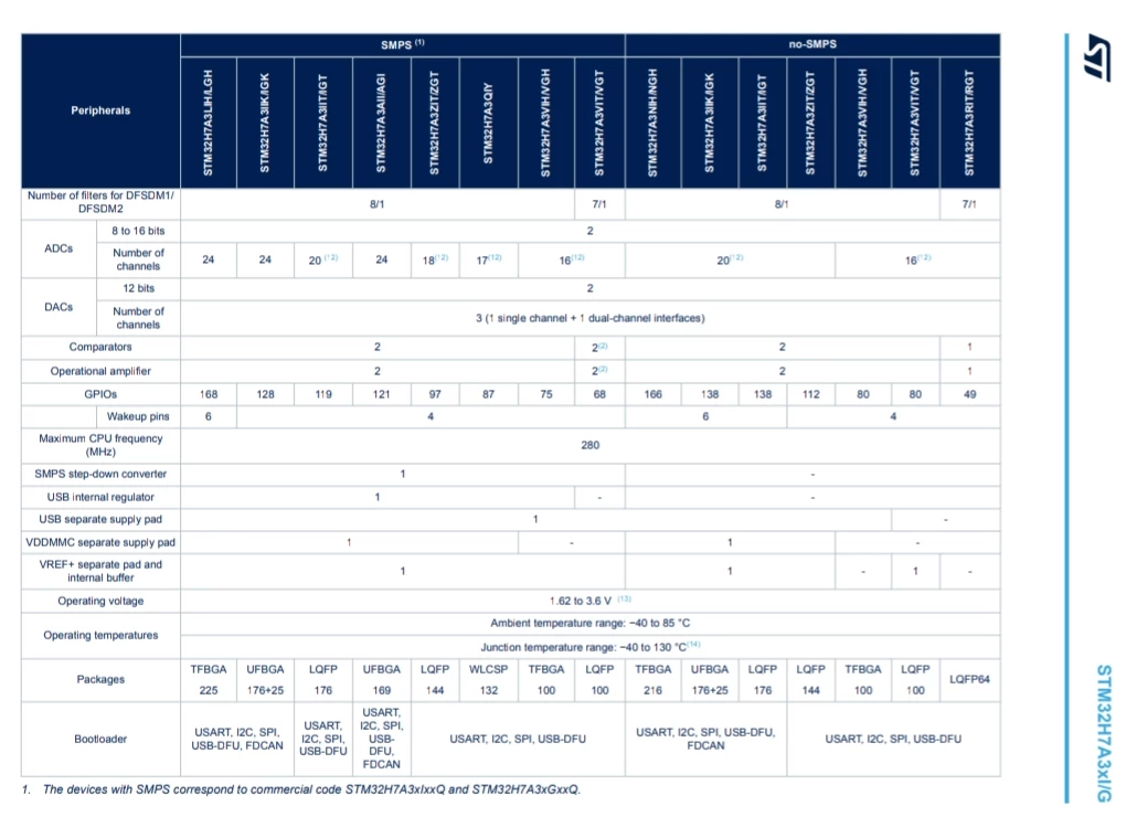

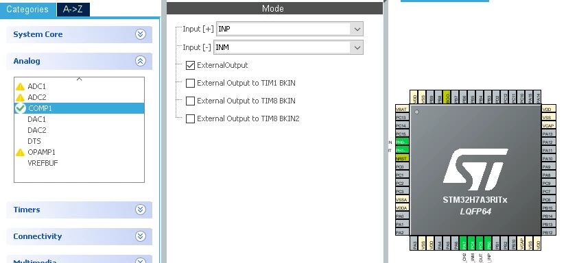

COMP2 not avalialble for H7A3RIT6 on CubeIDE 1.15.1
COMP2 is not listed on the configuration tool... eventhough it is well documented on the RM0455.
Please provide directions to activate and use properly COMP2 on the H7A3

    Hello @GMate.11
    As you can see on the DS13195, the STM32H7A3RIT6 provide only 1 Comparator (last column of the following screenshot):
    Best Regards.
