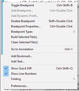

    Hello everyone,
    @TDK
    I am using a STM32G0x1 and, standing on what is written in the reference manual, this MCU should have the Data Watchpoin Unit.
    Anyway, if I try to write DWT in the expression window, the symbol is unknown and it seems that is not possible to add watchpoints (the menù entry is disabled).
    @unknown
    If I right-click on a breakpoint, the "Profile Instruction Counter" option isn't present in the context menù.
    Could it be that "Profile Instruction Counter" is an external plug-in or that my IDE version (v.1.11.2) is too old?
    Or that "Profile Instruction Counter" is a watchpoint context menu option, instead of a breakpoint one?
    Thank you,
    Carlo
