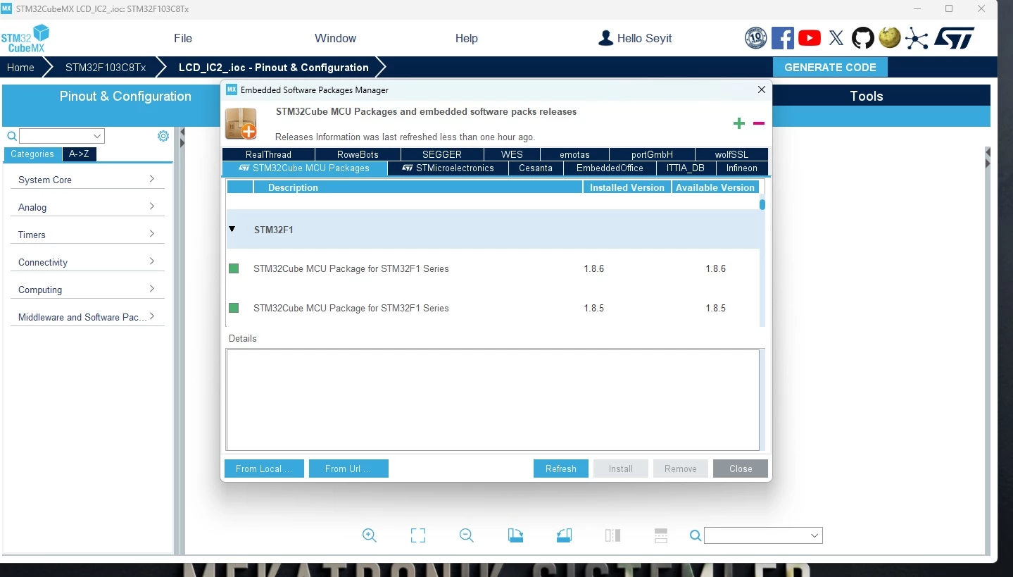

Most probably you are trying to generate a project starting from the standalone CubeMX or the one embedded on CubeIDE. This is an Error that means your project can be generated. It maybz the SDK of the MCU that you are using is not downloaded.
Can you give me a screenshot of the states of your project know ( the last thing you have done before the generation). Also, give me the context of your project wha MCU, What CubeMX and CubeIDE versions are you using...

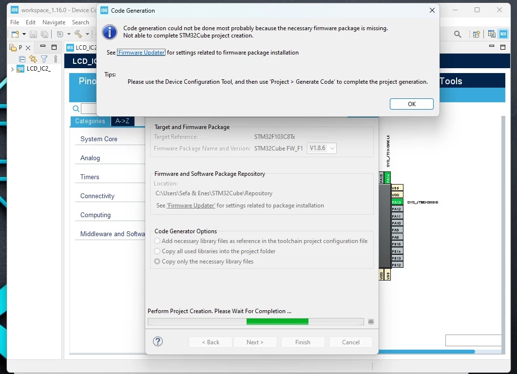

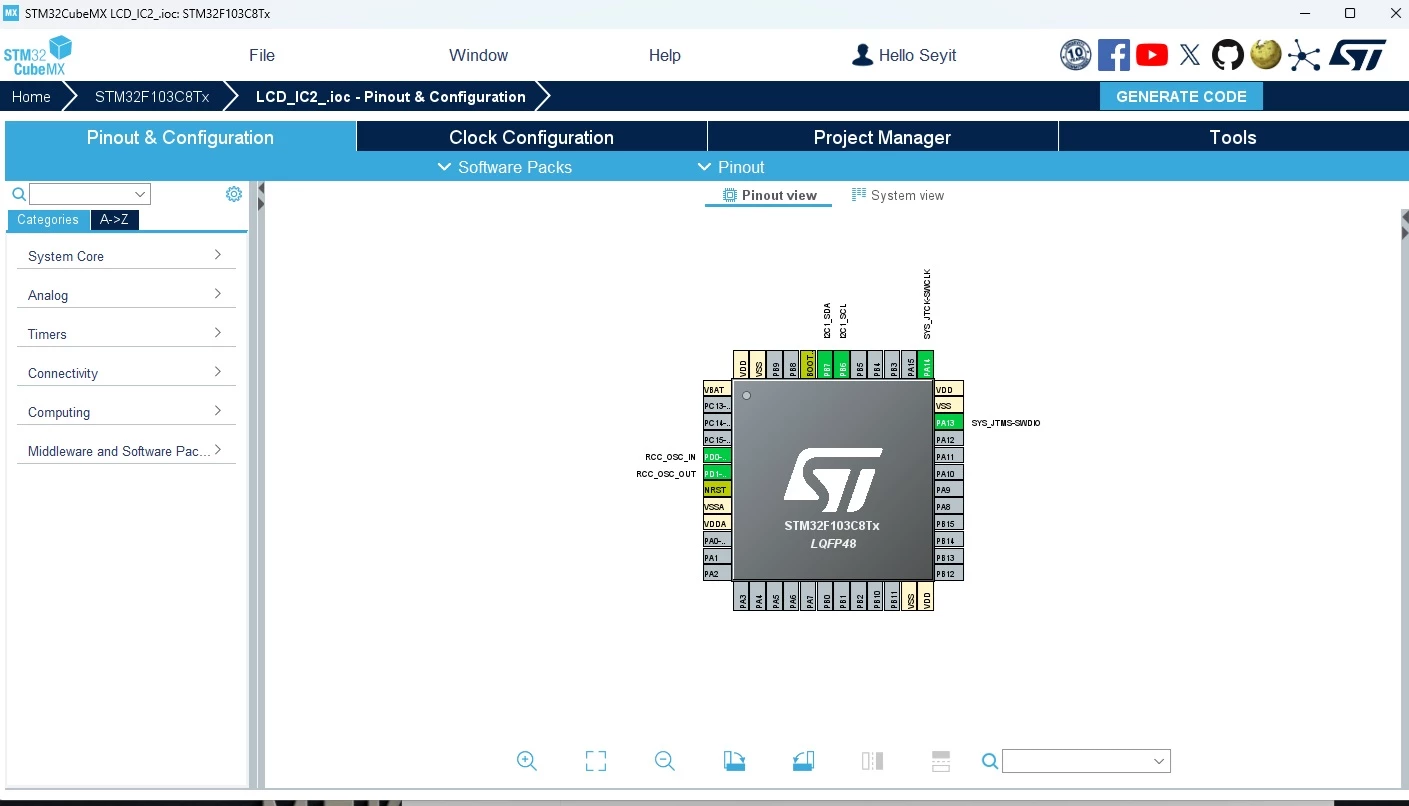

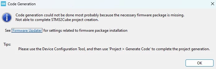

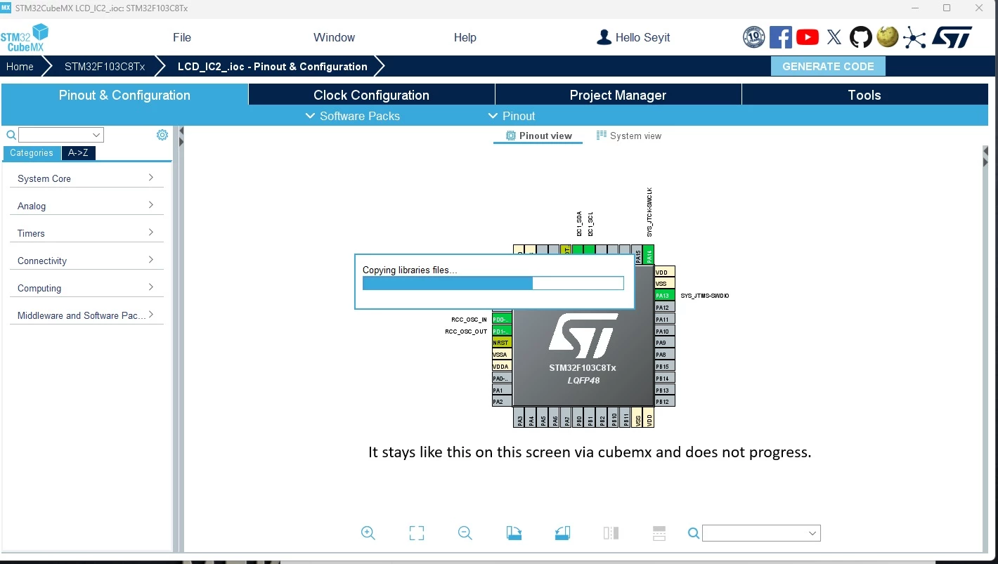

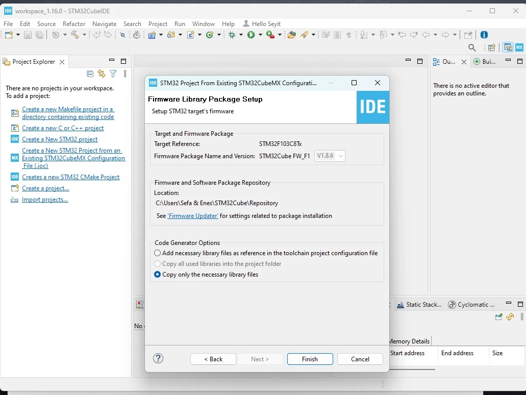

When you run the generator with cubemx, the application freezes as in the picture. I close the cubemx application and try with cube ide, this time it gives the firmware error in the picture for ide.

Generator'ı cubemx ile çalıştırdığınızda uygulama resimdeki gibi donuyor. Cubemx uygulamasını kapatıp cube ide ile deniyorum bu sefer ide için resimdeki firmware hatasını veriyor.

What CubeMX, CubeIDE versions are you using?
could you try as follow:
Start your project, configure your .ioc file and after finishing click on Project>code generation to generate the code (not Ctrl+s).
