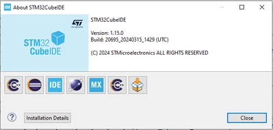

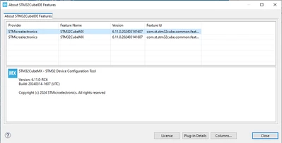

IDE version: 1.15.0
STM32CubeMX version: 6.11.0
