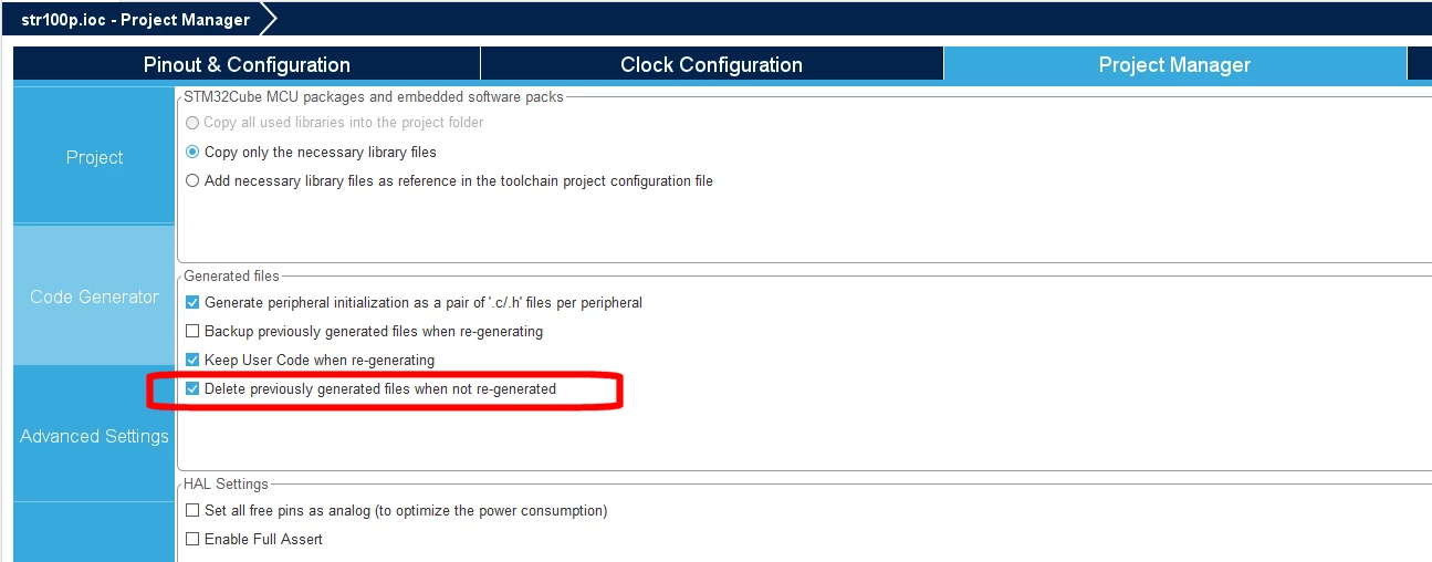

    September 24, 2024
    Do you have this option checked?
    If so, try un-checking it?
    DN19Author
    September 24, 2024
    Thanks for your suggestion. I already disabled this option.
    The adc.c and adc.h files are not deleted due to this checkbox. But unfortunately the necessary HAL drivers are removed when generating the code.
    Andrew Neil
    September 24, 2024
    Not sure what you mean by that?
    The adc.c and adc.h files remain, but there is no driver code within them?
