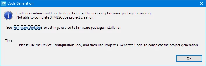

Code generation could not be done. Firmware package V1.24.1 can not be unzipped.
Get error message "Code generation could not be done because the necessary firmware package is missing. Not able to complete STM32Cube project creation."

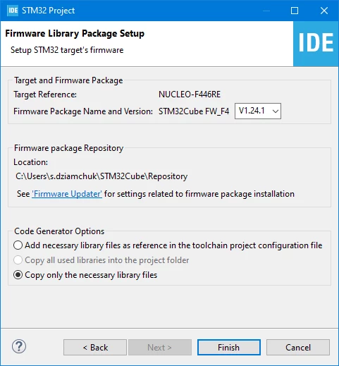

When Creating STM32Cube Project and then giving Finish will result the following

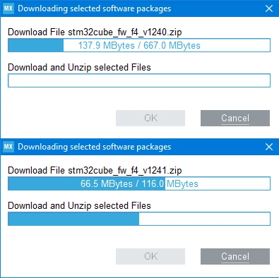

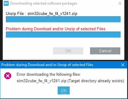

Also when downloading and unpacking software packages I get error when unpacking stm32cube_fw_f4_v1241.zip
If I select V1.24.0 package I get the same error (Problem during Unzip stm32cube_fw_f4_v1241.zip)

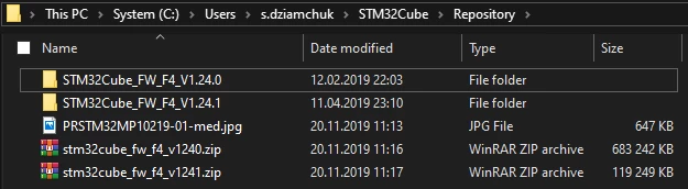

When I manually unzip v1.24.0 and v1.24.1 to different folders (like screen below) I still get Code Generation error.
I am using
STM32CubeIDE V1.1.0
Nucleo-F446RE board

@Reactor, unzipping within 2 various folders is not process IDE is intending to do. Please have a try to unzip within same directory.
F4_V1.24.0 is main FW pack delivery ... F4 V1.24.1 is only kind on patch to be applied on main delivery. If you have a look to .zip file size (or extracted material) you will confirm F4 V1.24.1 is missing some material ....

Well... The real problem is IDE can't replace files during unzip.

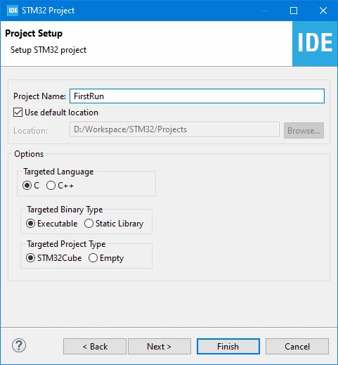

1) i have create new ST32 project in STM32CubeIde
2)I have selected the board, in my case STM32L475VGX, then i click next, write the project name and then it shows the error(code generation could not be done because the necessary firmware package is missing).
