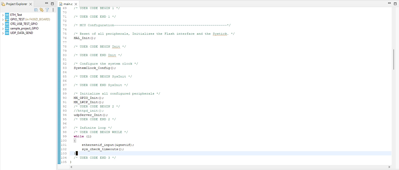

Well, you have changed the default structure of the CODE BEGIN/END blocks, which CubeMX cannot handle. In its raw state, the while loop looks like this:
/* USER CODE BEGIN WHILE */
while (1)
 /* USER CODE END WHILE */
 /* USER CODE BEGIN 3 */
/* USER CODE END 3 */
You have turned it into:
while (1)
 ethernetif_input(&gnetif);
 sys_check_timeouts();
...so the end marker of the block WHILE and the start marker of the block 3 are deleted. How should CubeMX then sort its own code?

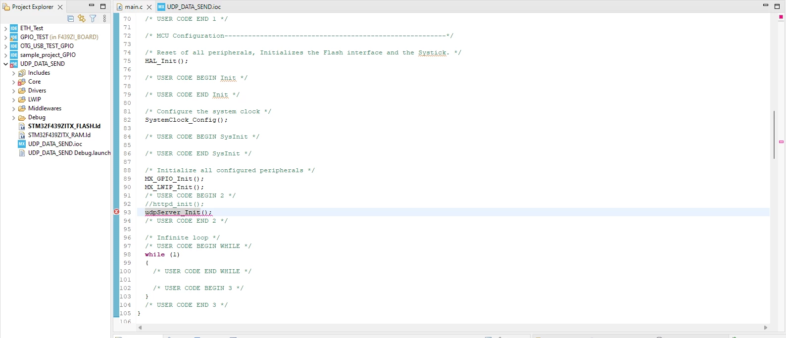

once again thank you for your quick reply, the below screenshot shows my example code before change in .ioc file.
The second screenshot shows my example code after changes in the .ioc file.
1. As you mentioned the code not within the "USER CODE BEGIN" deleted without further enquiry. That was done in function "udpServer_Init();".
2. But in the portion of
/* Infinite loop */
 my own written code was also deleted. this was written under the "USER CODE BEGIN" portion.
let correct me, where I had done the mistake. It happens every time. I suffer a lot from this.

May 3, 2024
Hi peter,
Thank you for your quick reply. I aware this mistake after sending this error message to you. After knowing this mistake, I tried my own "USER CODE BEGIN and END", it works fine.

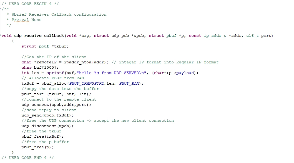

In the above screenshot, the sub-program and "USER CODE BEGIN" & "USER CODE END" written me, this also work fine. Thank you for great guide.
