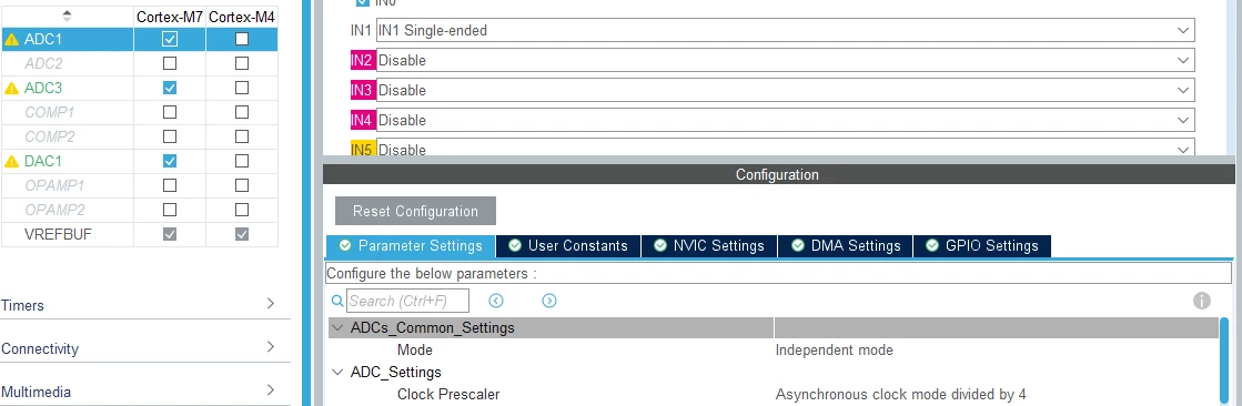

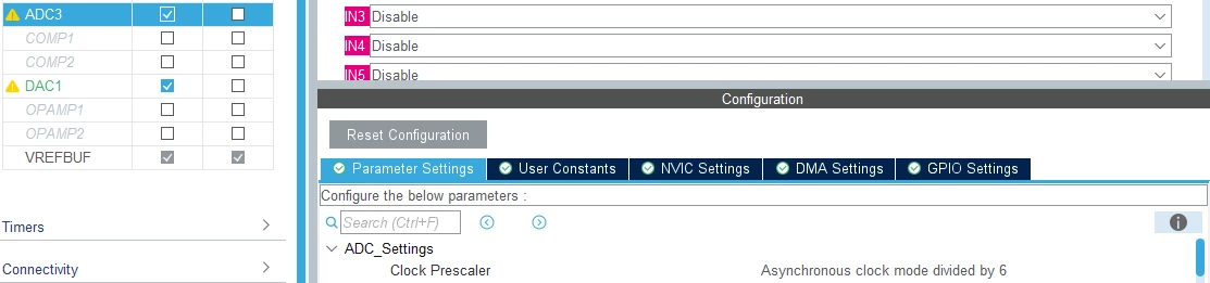

In the IDE GUI, when selecting asynchronous clock division for ADC3 on STM32H747XIH, the value generated in the code seems to be taken from ADC1, e.g.:
ADC1 (divided by 4):
ADC3 (divided by 6):
generated code (shortened):
/* ADC1 init function */
void MX_ADC1_Init(void)
 hadc1.Instance = ADC1;
 hadc1.Init.ClockPrescaler = ADC_CLOCK_ASYNC_DIV4;
 hadc1.Init.Resolution = ADC_RESOLUTION_12B;
 hadc1.Init.ScanConvMode = ADC_SCAN_ENABLE;
 hadc1.Init.EOCSelection = ADC_EOC_SINGLE_CONV;
 hadc1.Init.LowPowerAutoWait = DISABLE;
 hadc1.Init.ContinuousConvMode = DISABLE;
 hadc1.Init.NbrOfConversion = 2;
 hadc1.Init.DiscontinuousConvMode = DISABLE;
 hadc1.Init.ExternalTrigConv = ADC_SOFTWARE_START;
 hadc1.Init.ExternalTrigConvEdge = ADC_EXTERNALTRIGCONVEDGE_NONE;
 hadc1.Init.ConversionDataManagement = ADC_CONVERSIONDATA_DR;
 hadc1.Init.Overrun = ADC_OVR_DATA_PRESERVED;
 hadc1.Init.LeftBitShift = ADC_LEFTBITSHIFT_NONE;
 hadc1.Init.OversamplingMode = DISABLE;
 if (HAL_ADC_Init(&hadc1) != HAL_OK)
 Error_Handler();
/* ADC3 init function */
void MX_ADC3_Init(void)
 hadc3.Instance = ADC3;
 hadc3.Init.ClockPrescaler = ADC_CLOCK_ASYNC_DIV4;
 hadc3.Init.Resolution = ADC_RESOLUTION_12B;
 hadc3.Init.ScanConvMode = ADC_SCAN_DISABLE;
 hadc3.Init.EOCSelection = ADC_EOC_SINGLE_CONV;
 hadc3.Init.LowPowerAutoWait = DISABLE;
 hadc3.Init.ContinuousConvMode = DISABLE;
 hadc3.Init.NbrOfConversion = 1;
 hadc3.Init.DiscontinuousConvMode = DISABLE;
 hadc3.Init.ExternalTrigConv = ADC_SOFTWARE_START;
 hadc3.Init.ExternalTrigConvEdge = ADC_EXTERNALTRIGCONVEDGE_NONE;
 hadc3.Init.ConversionDataManagement = ADC_CONVERSIONDATA_DR;
 hadc3.Init.Overrun = ADC_OVR_DATA_PRESERVED;
 hadc3.Init.LeftBitShift = ADC_LEFTBITSHIFT_NONE;
 hadc3.Init.OversamplingMode = DISABLE;
 if (HAL_ADC_Init(&hadc3) != HAL_OK)
 Error_Handler();

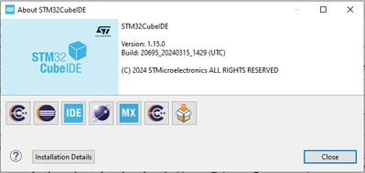

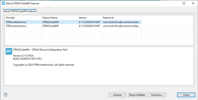

This is for project generated with STM32CubeMX v6.10.0. For project generated with STM32CubeMX v6.11.0, prescaler value for ADC3 is not even filled at all.
IDE version: 1.15.0
STM32CubeMX version: 6.11.0

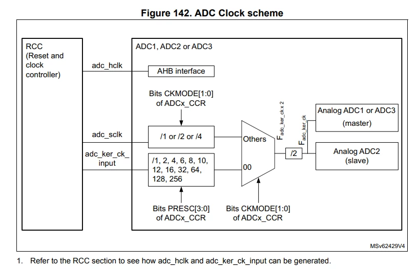

    AScha.3
    Apr 13, 2024 6:20 PM UTC
    The ADCs have only one common clock/prescaler here :
    So the setting can be only one for all ADC 1,2,3 .
    (read in rm...)

    STTwo-32
    STTwo-32Best answer
    Apr 17, 2024 4:22 PM UTC
    Hello @heveskar
    The problem is a CubeMX generation that i've reported internally to the concerned team under internal ticket number 179287. The Figure that @AScha.3 shared is commun for each ADC interface (ADC1, ADC2 or ADC3) and not for all three of them.
    Best Regards.
    STTwo-32
