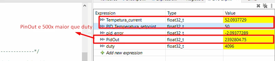

I'm using the stm32f429 discovery, I made a PWM control and tested it with a potentiometer and it worked as expected with 1mhz. Now I need to do the temperature control, I'm using a MAX31865 with PT100 and heating a resistance with the PWM output (this part is working very well) now for the PID it's not working right, I'm using:

I made a video to show how the PID is behaving:

    InsignificantBit
    January 4, 2024
    Hi.
    I suspect that the controller is just not tuned correctly and there is wind-up condition happening.
    Look up Integral windup and anti-windup techniques.
    matheuscaltran
    January 5, 2024
    I did other tests but instead of the PWM value of 1000 for 4096
    based on the test I did and because it blows the scale
    The PidOut variable is a float, so the maximum value of the float is: 3.402823466 E + 38 and the minimum value will be -3.402823466 E + 38
    When the setpoint temperature reaches the PidOut variable, it reaches a value much higher than 4096 (500x higher) because it is a float, then it starts to decrease the value but takes a while to reach below 4096
    (it takes a long time to reach the duty value)
    Video showing:
    With this, there would be some way to edit the maximum and minimum value of PidOut = arm_pid_f32(&PID, pid_error); specifically the arm_pid_f32 function
