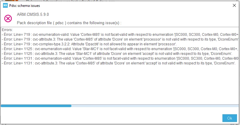

Hello Community,
I just wanted to install CMSIS Pack 5.9 in my CubeIDE (1.12.1), but the installation is canceled due to errors in the "pack" file:
ATM I am using CMSIS 5.7 Pack (Library) but for some reason the >>arm_atan2_f32<< function is missing. So the idea was to update to 5.9 (Source) and hope the function would be availiable then.
Has anyone an idea how to solve this issue?

    I have the same issue...5.9.0 will not install on CubeIDE 1.13.1

    5.8.0 will install no issues...but I cannot install 5.9.0, I get the same errors as above.

    Hello @CBerg @CMMPro
    The issue of CMSIS 5.9 Pack is solved in STM32CubeMx 6.10.0.
    I suggest that you download the software from this Link.
    Thanks.
    Mahmoud.

    thanks for the info @Mahmoud Ben Romdhane
    I don't use CubeMX as standalone application, but as plugin for CubeIDE. I hope that fix will be availiable in CubeIDE soon, too.
