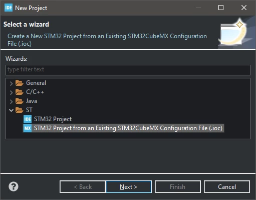

Hi @RSoen.1​ ,
I've had the displeasure doing this twice in the last week to port an existing project to two new targets. I can definitely tell you that you can't blindly file copy-paste and tweak the .project and .cproject files as the .cproject file has a bunch of guid-like values, which link things together. So when you add the new file copy-pasted projects into the existing workspace and try change any of the new projects options, it changes the original project options simultaneously (due to these 'guids' I guess?).
Our CubeIDE projects are 'customised' to use CMake so there wasn't too much ceremony required in just creating the new projects from scratch as we don't use the .ioc or any of the generated src, inc, folders at all.
From my experience, I would follow something similar to what @Imen DAHMEN​ suggests, and create a new ST project by from the current projects .ioc file, then either copy/paste all the source files into the new project location, or use Eclipse folder links to point back to the original projects code - see this for some ideas: https://mcuoneclipse.com/2014/08/15/link-to-files-and-folders-in-eclipse .
 0693W000006GHQXQA4.pngMatthew.
