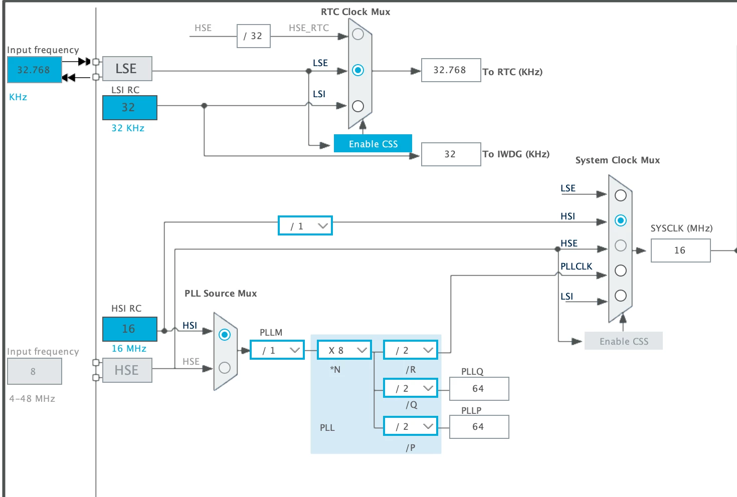

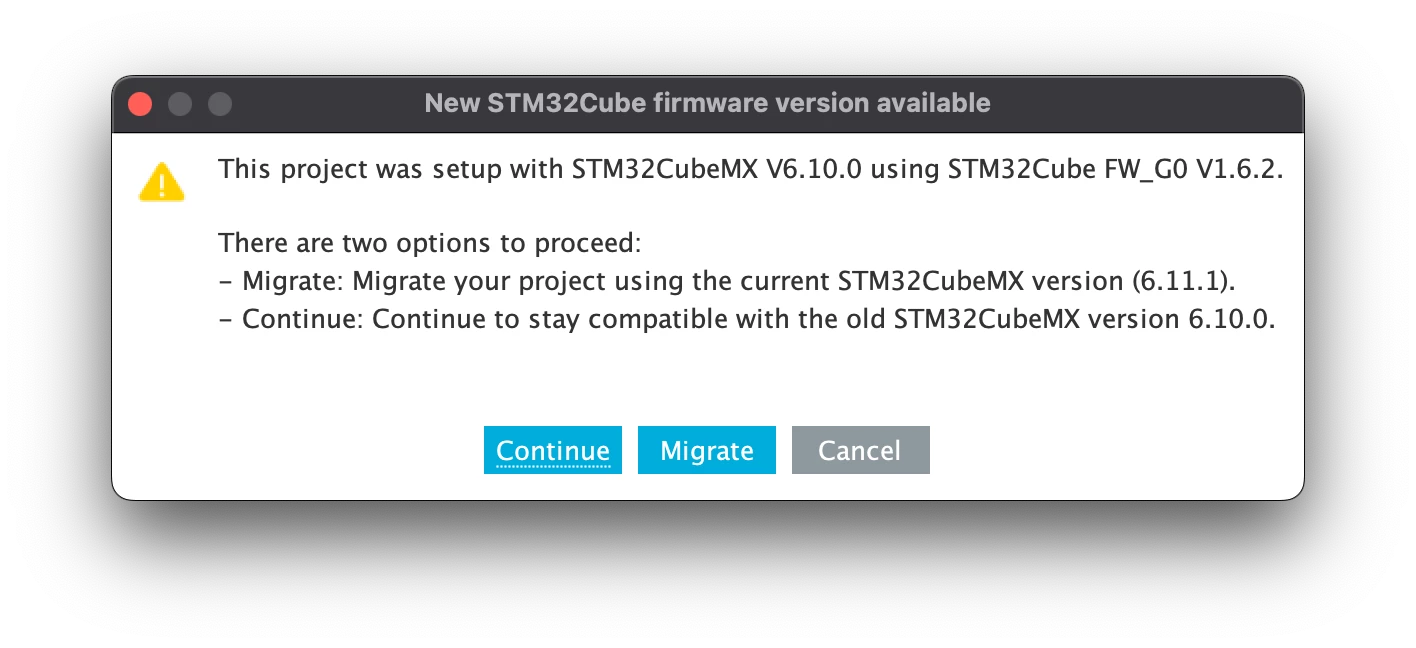

I am using STM32G030/STM32G031. After upgrading to STM32CubeIDE 1.15.1, when I click .ioc files and it will ask for two options:
If I choose Continue, Clock Configuration still works fine.

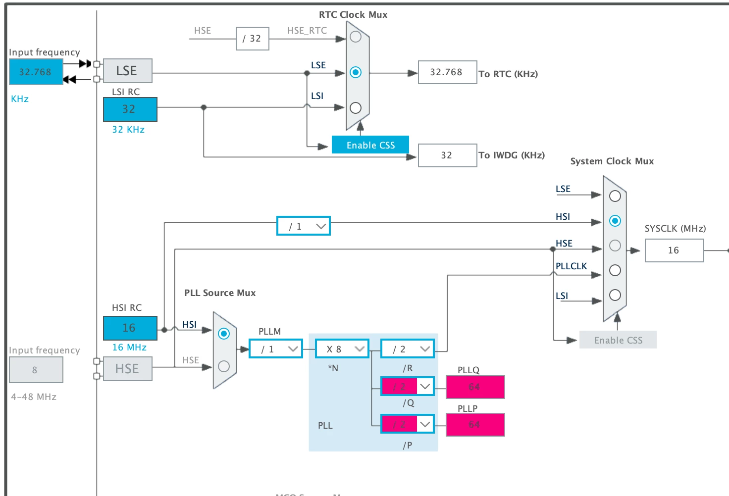

But If I choose Migrate, clock settings have error and I can't set to original values.

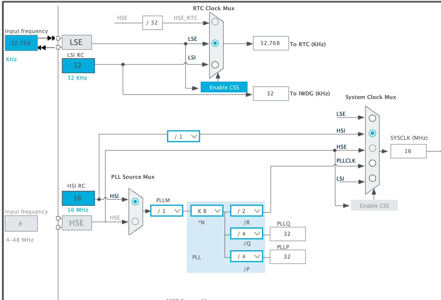

Using Resolve Clock Issue, the settings are changed and not possible to set to orignal values.

Please confirm which version is correct. Thanks!

If you go with mouse cursor to the red marked field, you get info : whats wrong here. Look.
You have the system/core at 16MHz , so maybe not allowed to set some peripherals to 64M.
Try with setting the system/core to 64 M. And then...?
Old version might not check for this limitation - so you get the "not allowed..red" only in newer version.

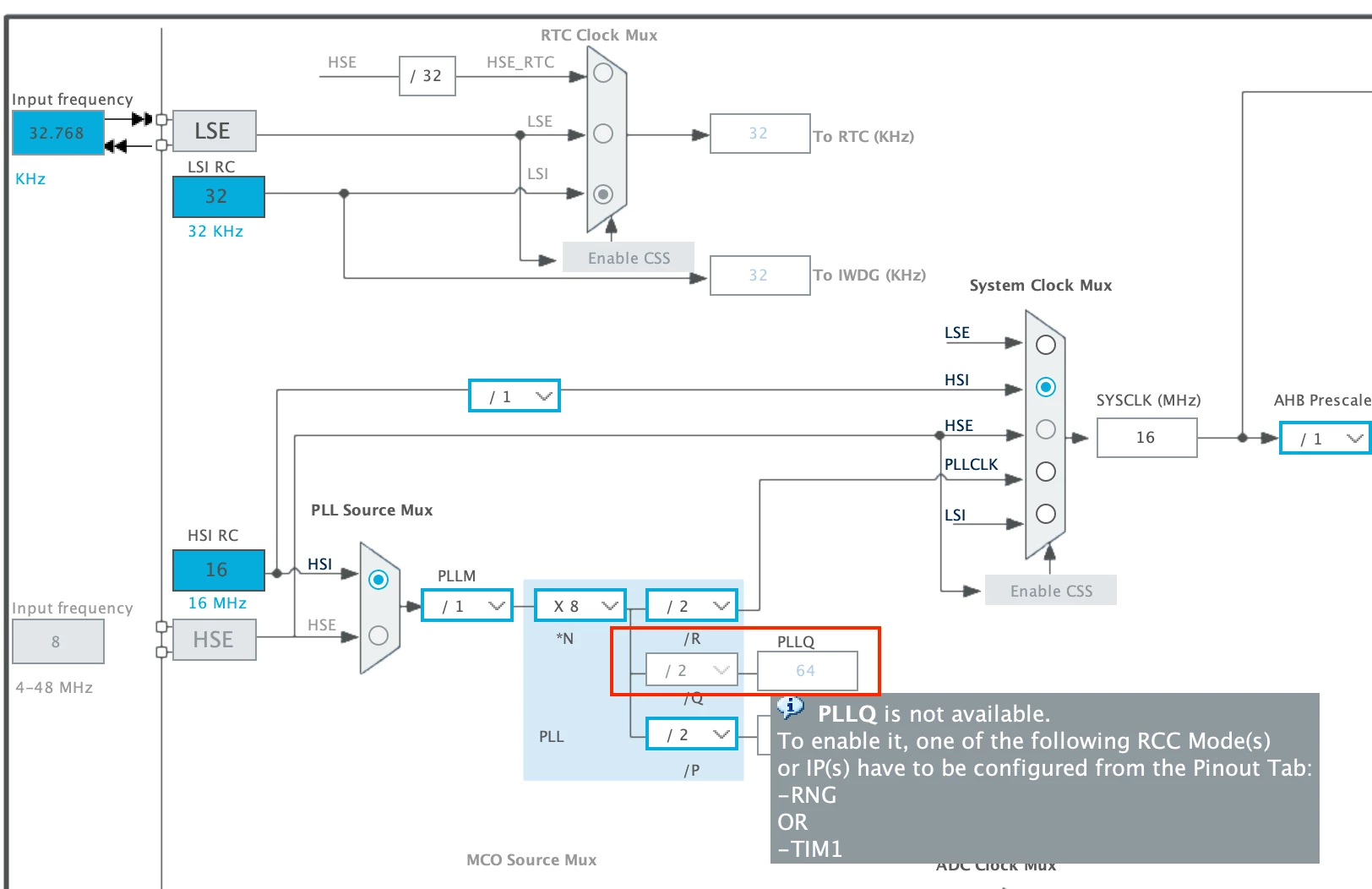

I think it IS a bug.
In version 1.15.1, PLLQ is always enabled. You can see the screen capture above, the PLLQ box is not dim.
But using 1.14.1, it is dim and disabled and with unavailable message.
