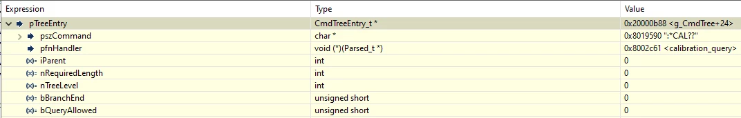

This is the memory address of pTreeEntry that is being placed in RAM but the address of pszCommand is not in RAM.
Any help would be appreciated.

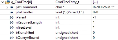

    I found a solution that works, thanks to a coworker of mine that had some helpful insight. I created a new function that will allocate RAM space for the character and copy it from ROM.
    static char * ROMtoRAM(char pszCommandContents[]){
    	size_t len = strlen(pszCommandContents) + 1;
    	char * target = malloc(len);
    	if (target == NULL) return NULL;
    	memcpy(target, pszCommandContents, len);
    	return target;
     With this function I can change where pTreeEntry->pszCommand is being pointed to and can actually write to the allocated memory.
    pTreeEntry->pszCommand = ROMtoRAM(pTreeEntry->pszCommand);
    *pTreeEntry->pszCommand = ITEM_SEPARATOR;
    I think this is acceptable to use so that it doesn't hard fault.

    I see what you are saying now about the * in front of pTreeEntry when I replace ITEM_SEPARATOR with ":" I get the same warning.
    Do you know a better way to accomplish the strcpy that is being attempted here? Sorry I am not super well versed in C and this code was written by someone around 25-30 years ago.
    dbolandAuthor
    June 22, 2023
    If I run it without the * in front of pTreeEntry the variable gets the correct value as well as a bunch of other repeating stuff.
    However, the next time pTreeEntry->pszCommand is written to I get a hard fault again.

    Please debug your program; try to understand why *pTreeEntry->pszCommand does not point to RAM.
    If you have not used the debugger yet, this is a perfect opportunity to get know the debugger.
    By the way, more clear (less confusing) syntax would be:
    pTreeEntry->pszCommand[0] = ITEM_SEPARATOR;
    dbolandAuthor
    June 22, 2023
    I have been using the debugger but without any success. I do not understand why it is pointing to ROM and not RAM, because the g_CmdTree has the pszCommand initialized in RAM but when pTreeEntry is set to the address of g_CmdTree[0] it is only seeing the ROM address.
    Pavel A.
