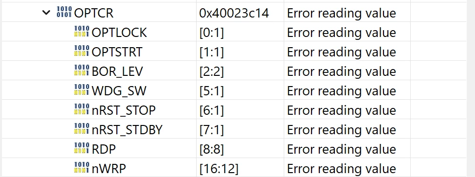

    Show a screenshot of the contents of the FLASH_OPTCR register just prior to the line where you set HAL_FLASH_OPTCR_OPTSTRT.
    There aren't any mechanisms for getting to RDP level 1 without modifying the option bytes and applying via the OPTSTRT bit.

    Before executing the line where I set HAL_FLASH_OPTCR_OPTSTRT:

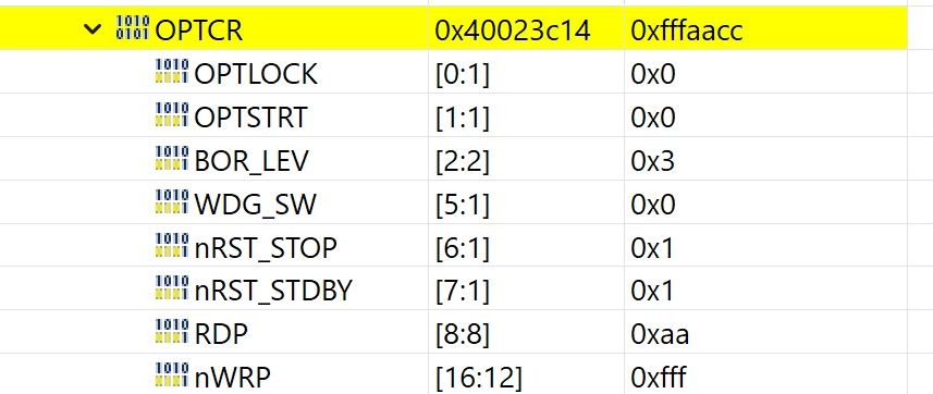

    After Executing the line where I set HAL_FLASH_OPTCR_OPTSTRT:

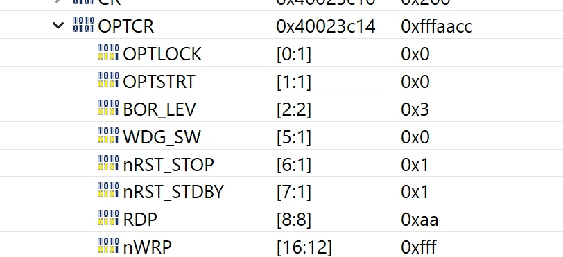

    After Executing wait instruction for Busy flag to be cleared:
