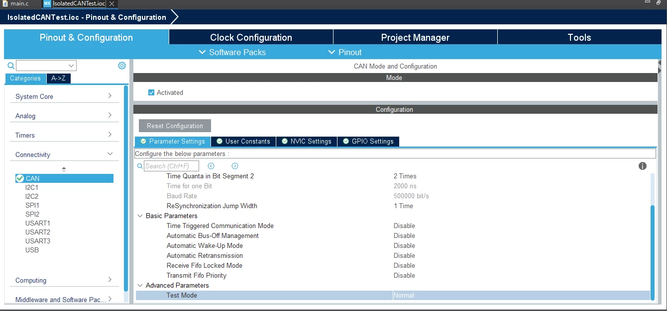

I am working on STM32F103 for a project with CAN. While working I set the CAN Test mode to Loopback in the ioc file, afterwards I set the test mode back to normal mode. but this change was not updated in the main.c file. In main.c file, the line in MX_CAN_Init(void) function still is as following.
hcan.Init.Mode = CAN_MODE_LOOPBACK;
 I cleaned the project and then again built the project, still it is same, I tried to change the test mode multiple times, but every time it asks if code should be generated and I select yes, still the code is not changing. Why is this happening?
CAN configuration:
Generated code

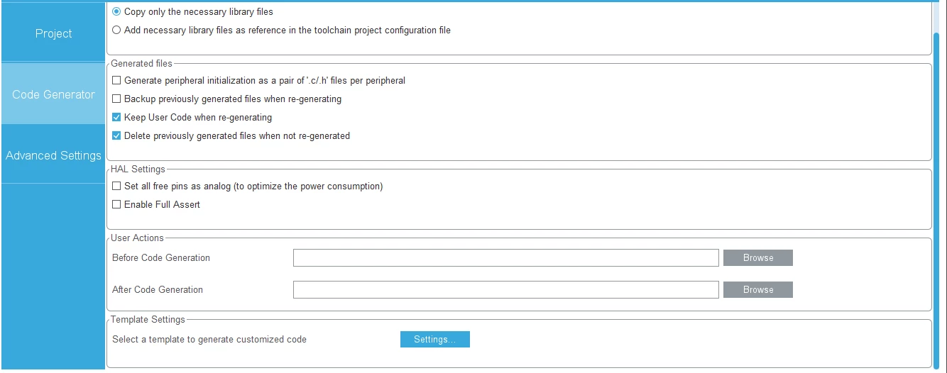

Code Generator settings

Don't forget to click on this button after changes on the .ioc file:
or click Ctrl+s to save changes.
GladsonAuthor
Apr 12, 2024 10:01 AM UTC
I have tried clicked that "Code generation button" and also pressing ctrl + s, both did not work.

Thanks for testing it out! I am using the same version that you mentioned for STM32CubeIDE and STM32CubeMX. Is there anything else that I could have messed up? I also used git in this project, could that affect the project in any way?
RZasa.1
Nov 19, 2024 11:01 AM UTC
I had similar problem, it turned out that package for my microcontroller was not installed. You usually get this information when creating new project but I have copied it from another PC and there was no message.
ChrisOKay
Mar 25, 2025 7:29 AM UTC
This was it in my case as well. One would think that the code generation process automatically detects that the firmware is missing, but it just results in silently not updating the code. The only hint is that the process is quitting "too fast" - and that nothing changes in the code.
