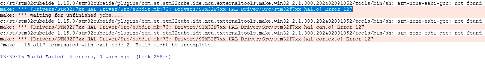

Hi,everyone!
When I build a project, I get the errors "c:/st/stm32cubeide_1.15.0/stm32cubeide/plugins/com.st.stm32cube.ide.mcu.externaltools.make.win32_2.1.300.202402091052/tools/bin/sh: arm-none-eabi-gcc: not found" and "make: *** [Drivers/STM32F7xx_HAL_Driver/Src/subdir.mk:73: Drivers/STM32F7xx_HAL_Driver/Src/stm32f7xx_XXX.o] Error 127"(XXX is the name of the file.) in the CDT Build Console for no apparent reason.
The number of these errors changes each time I build, making it difficult to identify the cause of this problem. No matter how many searches I did, I could not find anything, and when I checked with my colleagues, no one was aware of these errors. Can someone please help me with my biggest question.スクリーンショット 2024-06-22 135756.png

is this your first project ?
Did you make already working projects ?
Did you "generate code" ?

June 22, 2024
First of all, thank you for replying.
Q1. is this your first project ?
A1. No,I am on a team that builds robots and we are writing a new code for the next competition.
Q2. Did you make already working projects ?
A2. Yes,I have written code for several robots and they actually work.
Q3. Did you "generate code" ?
A3. Of course!
These errors occur during the process of generating code and writing the program.
A program that worked 5 minutes ago may suddenly get this error.

Hmmm...
error: xxx.o not found , so compiler output file not existing or deleted.
A: still much free space on drive/partition ?
B: "someone else" delete the files - antivirus/firewall etc active ?
C: if you open other, old project and (re-)compile - does this work without errors ?

Probably the multi-threading  -j  option, things didn't complete, parts left unbuilt.
lamzawaAuthor
June 24, 2024
Can you please tell me what is  "the multi-threading  -j  option" ?
