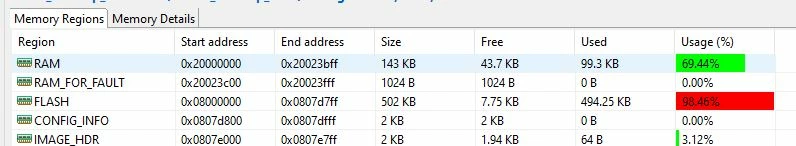

Cube's IDE show the sections seems to work:

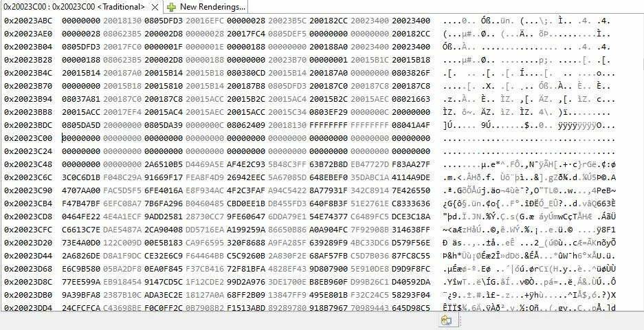

But once the debugger is loaded there seems to be a lot of random data around the 0x20033C00 memory spot:
Could the stack still be using the chips high RAM address or is there something else we need to do to isolate the highest 1K of RAM?

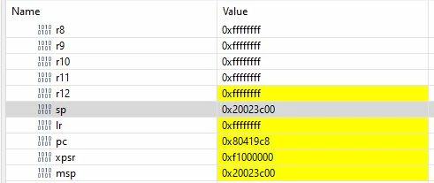

    If we stop at the beginning of main() and step into the first functions call, it appears to load data onto the stack at about address 0x20023BDC and then start using lower RAM addresses:
    So the stack appears to start correctly from main. Is there a difference between a power up condition and a reset where a power up may use those high RAM addresses?

    So at the Reset handler, the stack pointer shows 0x20023C00.
    If I fill in random data and run till I hit main(), the random data is still present.
    Do power up conditions use the highest RAM addresses? If it only happens on a power up(and Not on a reset), this would work fine for a HardFault problem.

    BarryWhit
    Lead
    Jul 16, 2024 8:49 PM UTC
    Looks pretty random to me.

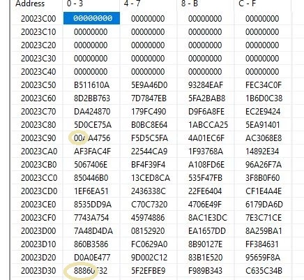

    I encourage you to pull the power, wait for for 5 minutes (and wave your heat-gun on low over the chip) then repeat the test - because I'm not sure what we should expect to see and I'm curious to know. But this looks very much like random data.
    Update: follow up to DeLorean's suggestion below - the SRAM cells might exhibit preferential  (value-dependent) bit decay behavior. Try filling with all-zeros/all-ones, and repeat the power cycle test. See if a pattern emerges.

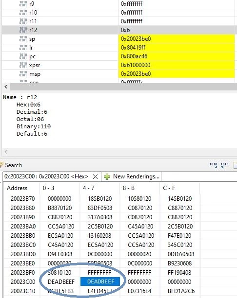

    You are probably correct. Long power cycles still result in the same type of data in RAM even after it had been cleared. It all seems to work after software resetting the processor from a induced illegal address write including the simple checksum verification. If anyone wants the code let me know and I'll post the two functions needed(one in the HardFault handler and one in main.
    After digging around the HardFault so much I'm going to put a quick stack fill to trace how much the current code base is using.
