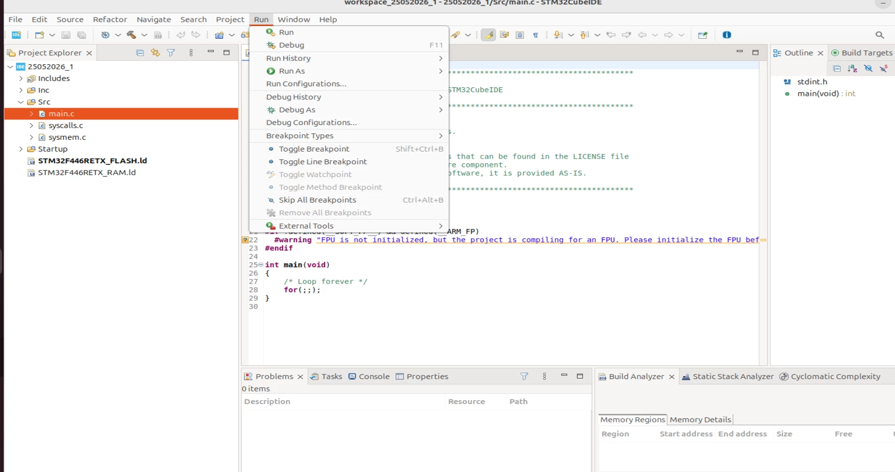

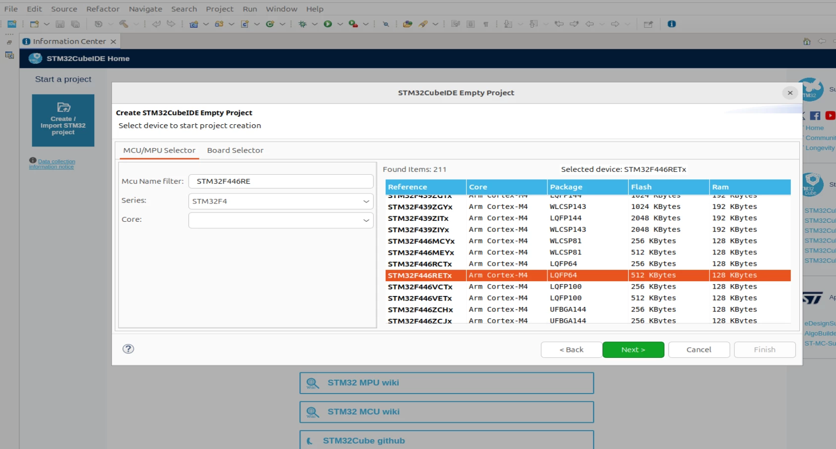

I am struggling getting my code generated and to compile it..

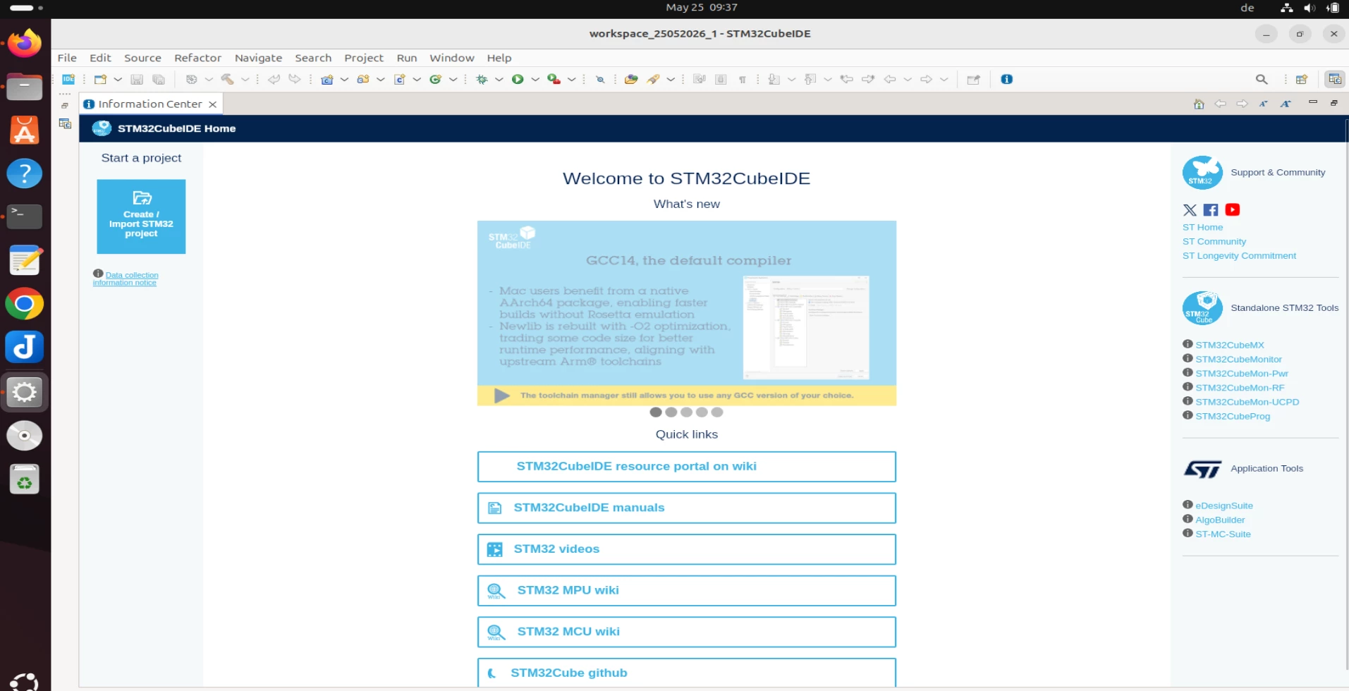

I am working on VirtualBox with Ubuntu OS, and I have downloaded the standard Linux STM32CubeIDE.

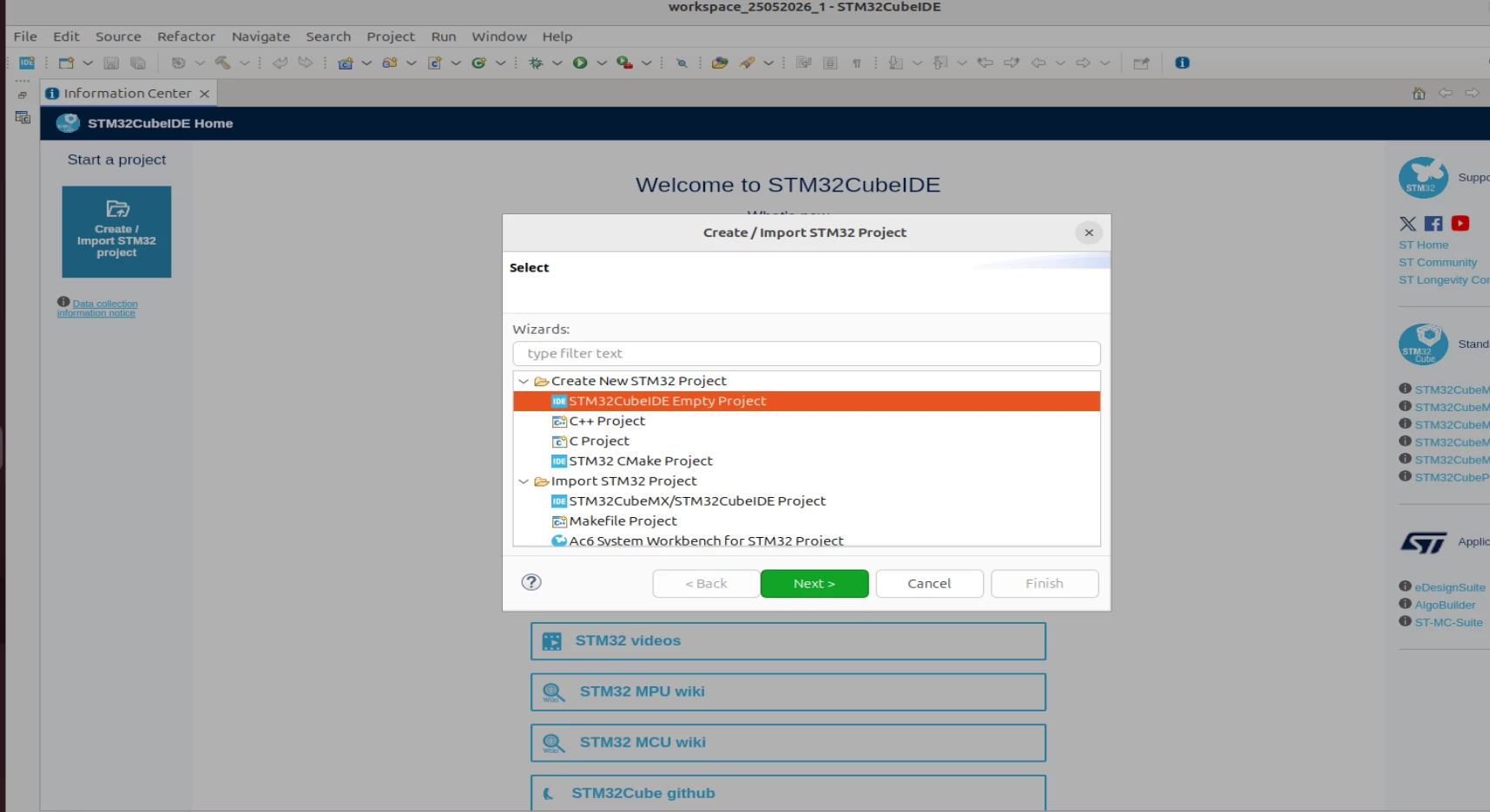

When creating a project, my mcu ode is not being generated within the files..4079ae4c-73ab-7653-f594-f05905f3a826.pngf7eac302-a802-6e9e-397c-11f921372c74.pngbac38fad-66b7-e346-7643-5959194db0ea.png1b69b4b7-4498-2fc9-6e20-f1c717f8f898.png

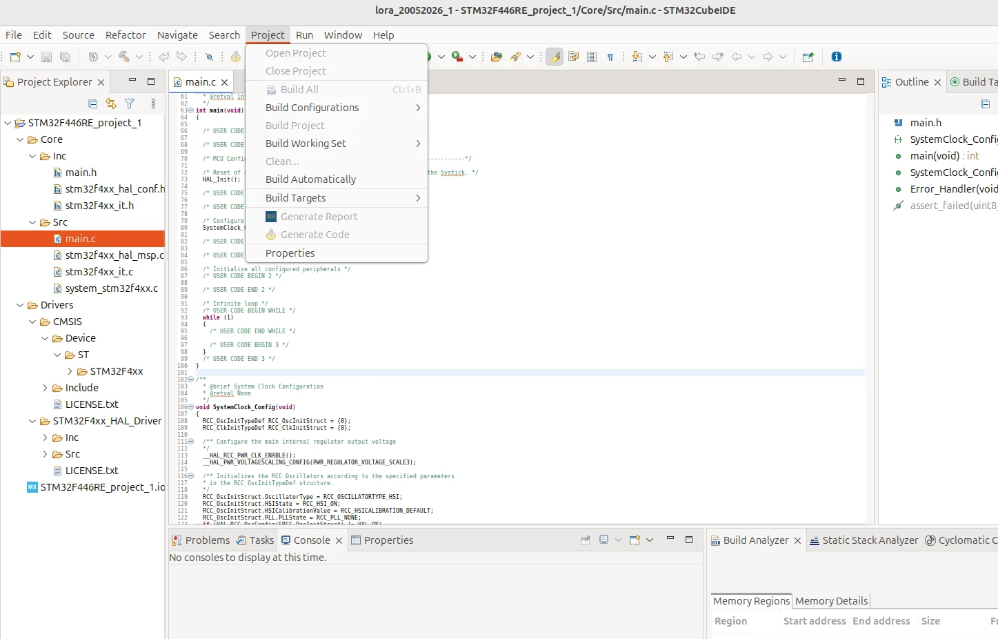

I had also installed the STM32CubeMX and was able to select my HW there and I get my code generated properly.. but I cant import it into STM32CubeIDE... if I import, then I cannot Build the code... (picture below)

Hello  and welcome to the ST community,
It seems you are using a CubeIDE version older than 2.0.0.
I suggest to use the latest version 2.1.1 (currently) and use CubeMx to generate the code.
Please read the new workflow on STM32CubeIDE 2.0.0: STM32CubeIDE 2.0.0 workflow tutorial
