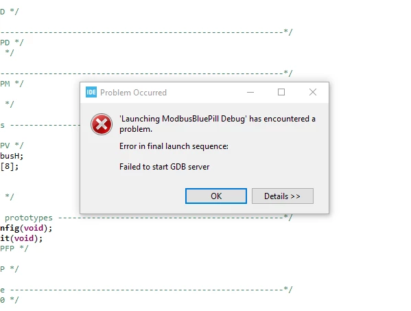

Cant enter into debug mode
I am fresher here for the ST cube IDE i am trying to debug my code but it showing this error msg

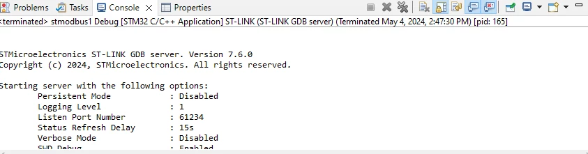

    AScha.3
    Dont see something in console output ?

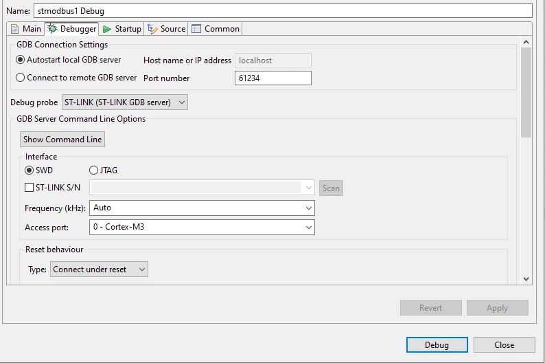

    What you set in debug settings for your project ?
    NeetuAuthor
    This is my  console output.
    The debug settings are

    What is your st-link? The V2 stick?
    Try connect: with type: software reset.
    NeetuAuthor
    yes, The V2 stick
    tried with software reset still facing the same
