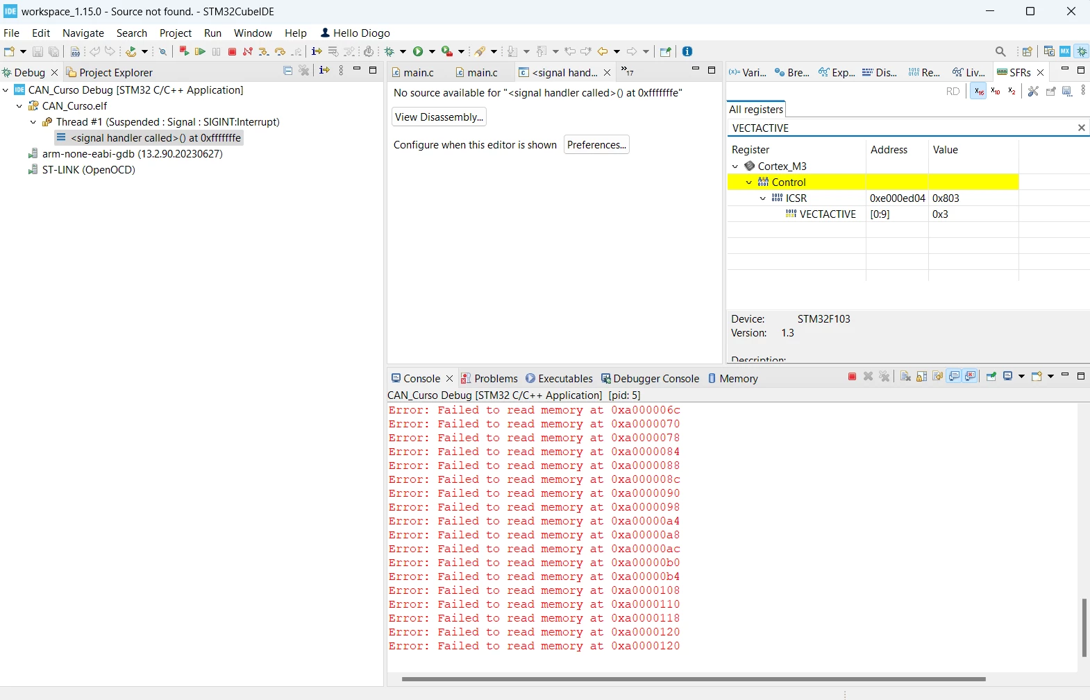

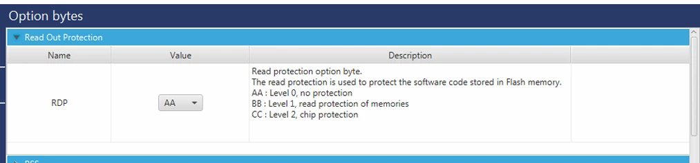

I'm a new user working with a Nucleo F103RB board, and it suddenly stopped working. I can't program, debug, perform a chip erase, or access any sector. It began showing vFlash errors and is now stuck in a lockup stage. I've attempted to upload a different project with no success, and I've also tried a full chip erase, which failed. Additionally, it has entered read protection mode, preventing me from reprogramming the RDP using any other IDE or programmer utility.When i try to change the RDP in cube programmer it shows a error cant read data and the board disconnects itself. Is it a hardware problem?If so I could solder a new microcontroler in the nucleo.

    Address here seems Wrong, and not in memory map.
    Should be able mass-erase an F103 to clear RDP

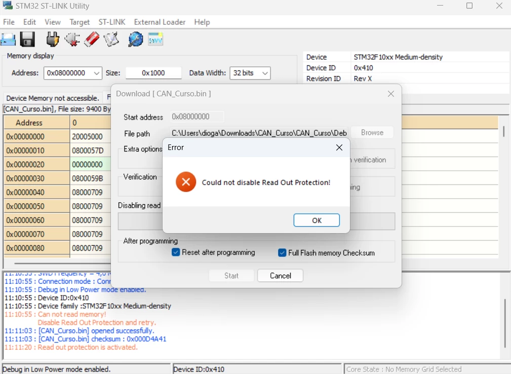

    Right now, I can't erase anything with the ST utility or programmer because the application crashes or says the Nucleo got disconnected. The error occurred just after I uploaded code to the Nucleo.
    I'll try the jumper solution tomorrow to see if anything changes. I'll also check for any shorted components.
    May 14, 2024

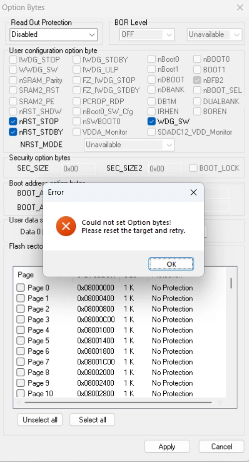

    It doesn't seem to have changed anything. When I tried to program via ST Utility, it asked me if I wanted to disable readout protection, but it threw an error when trying to do so. Then the device disconnected itself, even with the jumper on Boot0 and VDD.Also couldnt do a full chip erase.
    Also when trying to disable read out protection

    Could it be the power supply were cut while programming?.. but according to the ST-LINK utility (a deprecated tool) you can read the Flash content!
    May 14, 2024
    But how? It says read data failed,even in the cube programmer.
