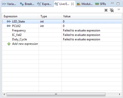

Cannot get "Live Expression" to show results in CubeIDE, there are no compile errors.
I have a design where I am trying to calculate the frequency of an incoming signal. I am using STM32CubeMX
 and STM32CubeIDE combo. My process is to use "Live Expressions' within DEBUG to see the results. My platform
 is STM32F303RE.
 The code clip below is the CallBack Routine that is defines in my main.h file. The main.c snippet is as
 follows:
  void HAL_TIM_IC_CaptureCallback(TIM_HandleTypeDef *htim)
  if (htim->Channel == HAL_TIM_ACTIVE_CHANNEL_2) // rising edge interrupt
  // read capture value
  IC_Val1 = HAL_TIM_ReadCapturedValue(htim, TIM_CHANNEL_2); // first value
  if (IC_Val1 != 0) // if the value is not 0
  //read second value
  IC_Val2 = HAL_TIM_ReadCapturedValue(htim, TIM_CHANNEL_3); // falling edge value
  // calculate Duty cycle
  Duty_Cycle = (IC_Val2*100/IC_Val1);
  // calculate frequency
  Frequency = (2*HAL_RCC_GetPCLK2Freq()/IC_Val1);
  // As my timer2 clock is 2X the PCLK1 CLOCK, that's why X2.
  else
Duty_Cycle = 0;
  Frequency = 0;

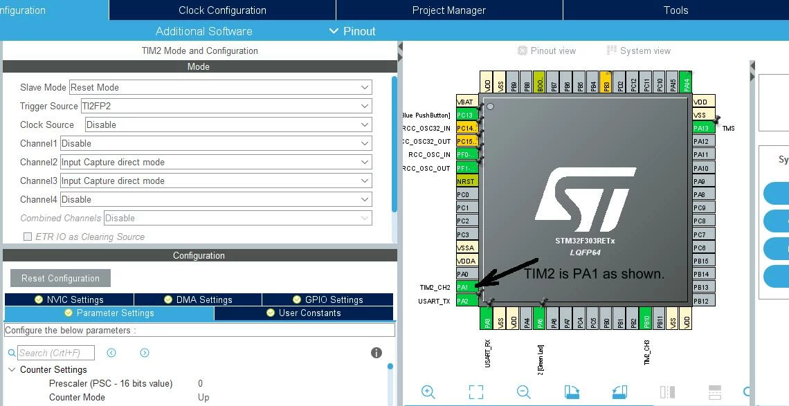

 The TIM2 setup within MX is:
 The "Live Expression" window is a shown:
 I added the PCLK2 HAL READ and LED_State to make sure I am using the tools correctly. These variables
 are working fine in Live Expression.
 A little professional help here would be highly appreciated.
 Please take a look and see what is stopping these variables from being processed and viewed.
 Thanks
