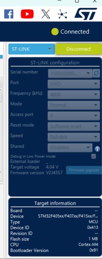

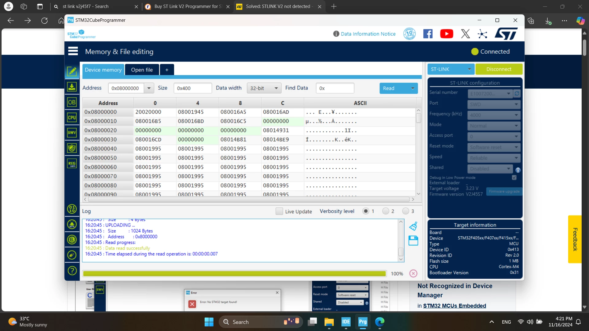

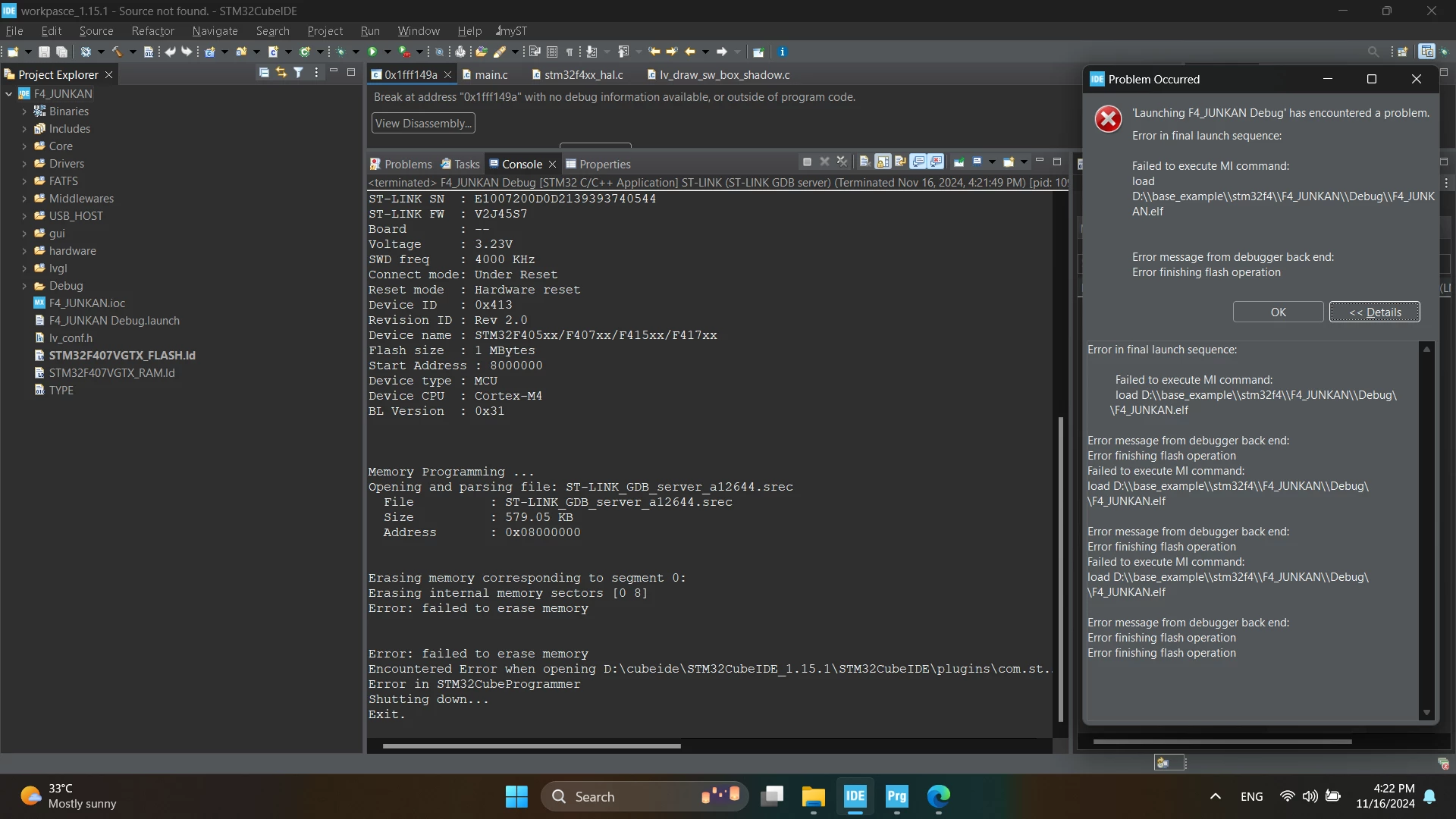

hi i am having a problem with my stm32cubeide, specifically i cant connect to the stm32f407vgt6 microcontroller on my custom board, but when loading or erasing with cubeprog everything goes smoothly.
i have tried cleaning my board, updating stlink to v2j45f7, reinstalling stm32cube1.15 since i previously updated to 1.16. still nothing works.
can anyone help me?
edit : this my log debug

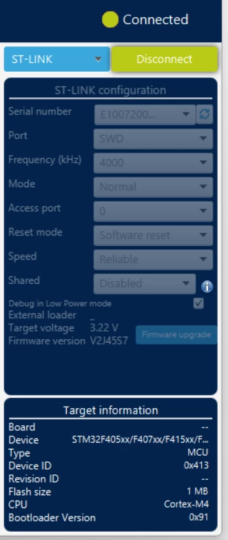

hi, thanks for last week's question, sorry for not replying you earlier, but the good thing is that I solved my problem completely, basically I got another stlink to use and it has no problem anymore.
but I wonder why the old stlink with target voltage of 3.23v can debug or use normally with stm32f103c8t6 chip but cannot debug for stm32f407vgt (must use another stlink with target voltage between 3.57,-4.5v to debug and use normally)? Screenshot 2024-11-24 084644.png

Hello @OWLchan
The STM32F407 series typically has higher power consumption due to its advanced capabilities  (like higher processing power, more peripherals, etc.) compared to the F103 series. This means that it may require a more stable power supply during debugging, which could explain why a higher voltage is needed for reliable operation.
