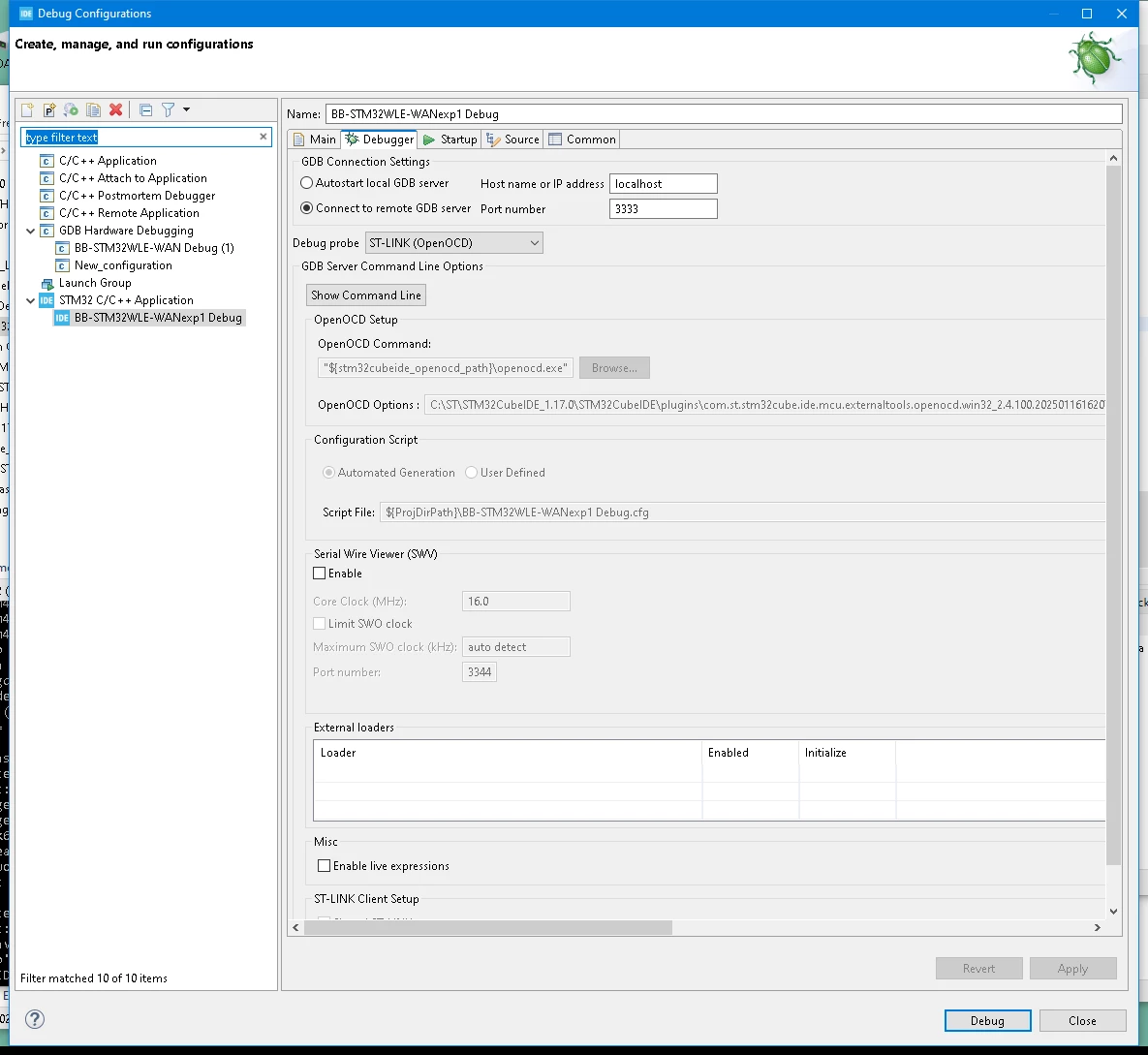

I have got a new CMSIS-DAP debugger, and I tested it with Keil 5 where everything works fine. Now I want to use it in STM32CubeIDE.
My configure file for OpenOCD my_cmsis.cfg is
source [find interface/cmsis-dap.cfg]
transport select swd
source [find target/stm32f1x.cfg]
reset_config srst_only
and OpenOCD is started with command openocd.exe -f .\my_cmsis.cfg
In CubeIDE, in the "Debug Configurations..", in debugger tab, debugger was set to ST-LINK(OpenOCD) and GDB connection setting was set to connect to remote GDB server, port 3333. After click Debug, an error shows up:

Maybe you have to untick the live expression in debug configuration. This is using a second gdb connection.
Or use the openocd from CubeIde.
Rgds,
Laurent
Lsy.1
Lsy.1Author
January 28, 2021
Untick the live expression and the program loaded without any problem.

Settings for the debugger:

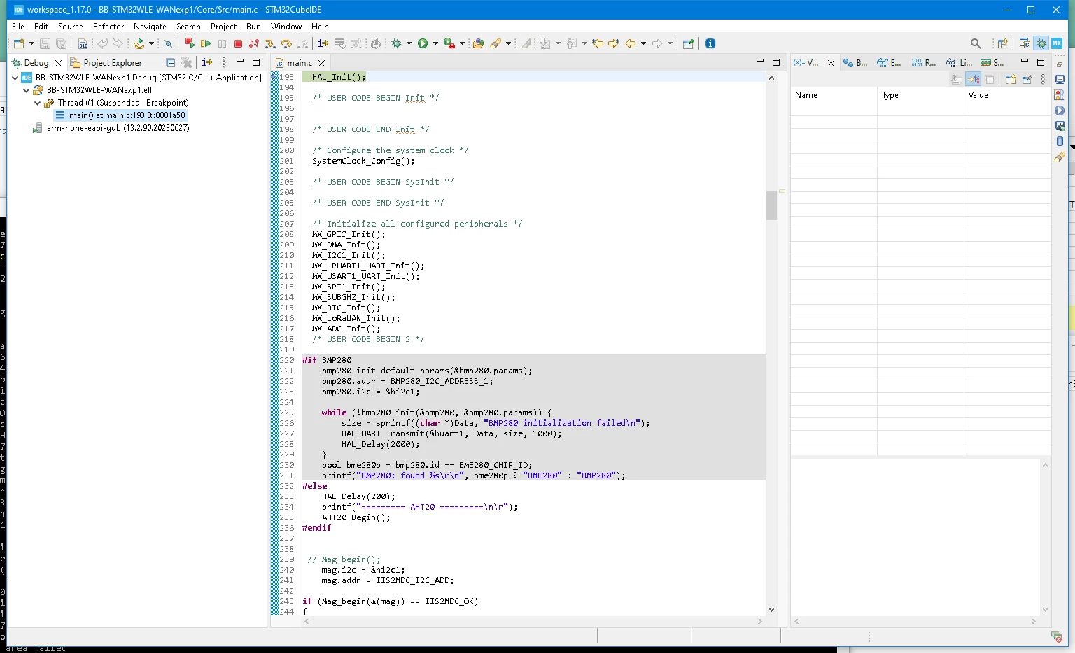

Screenshot of a debugger session:
