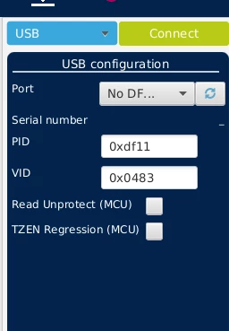

    MDeAuthor
    September 29, 2024
    Hello Ascha.3,
    Thanks for your quick reply.
    Thank you for telling me that an ST-Link debug probe is not necessary, that's what I thought.
    Thank you also for telling me that ST LINK Utility is useless.
    I just did what you said:
    - Set the BOOT0 signal of the STF32F107 component to High using the jumper on my board.
    - Reconnected this board to the USB of my PC. A LED is lighting meaning the board is powered up but I still don't hear any connection beep when I insert the USB cable into a USB slot on my PC (this slot is working with other devices)
    - Started STM32Programmer, chosed "USB" click on "Connect" but still nothing happens, I get the error message "Error: Establishing connection with device failed", screenshot attached.
    Can you help ?
    Regards,
    MDe / Belgium

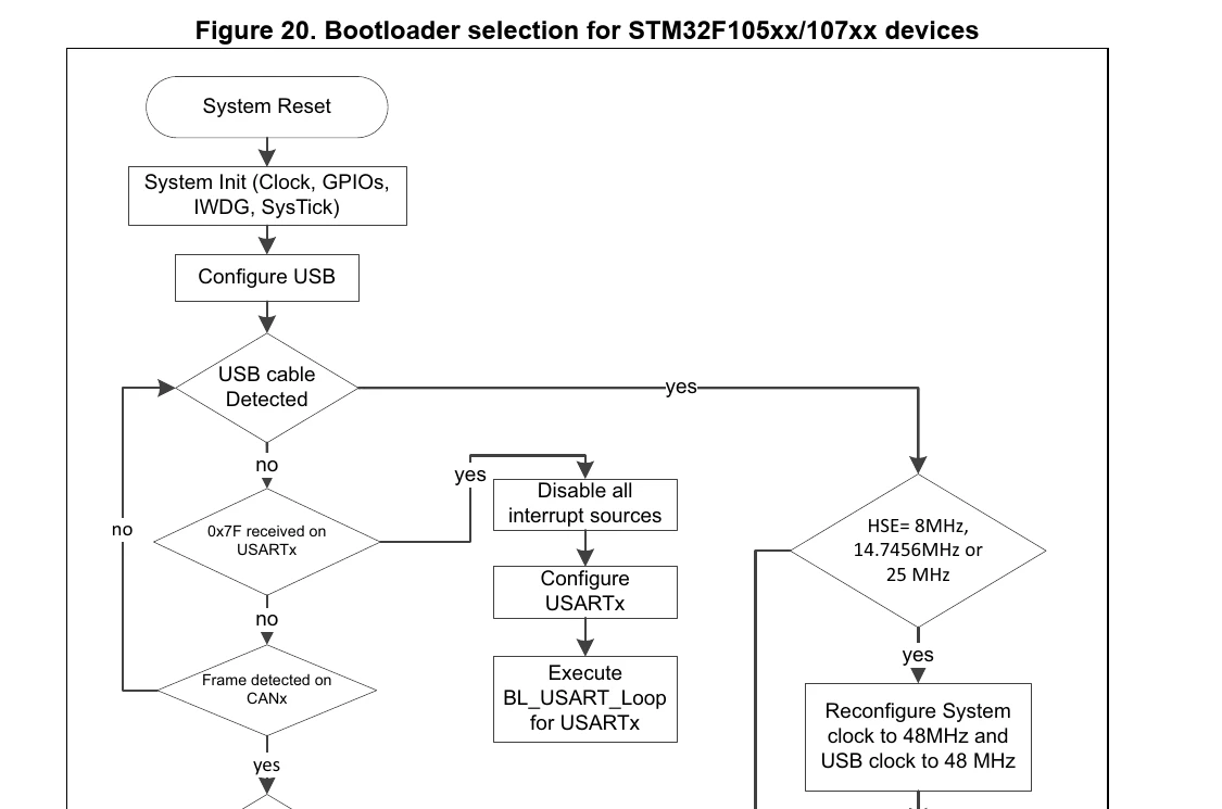

    AScha.3
    September 29, 2024
    >Can you help ?
    no. :)
    Just - your PC has to "see" the new USB device - otherwise nothing will happen.
    So try other plug, cable - until you see it (in device manager ) or get ding-dong...
    + set jumpers boot0 hi , boot1 lo.
    is you clock /crystal on board:
    check it.
    + read AN2606 ...
