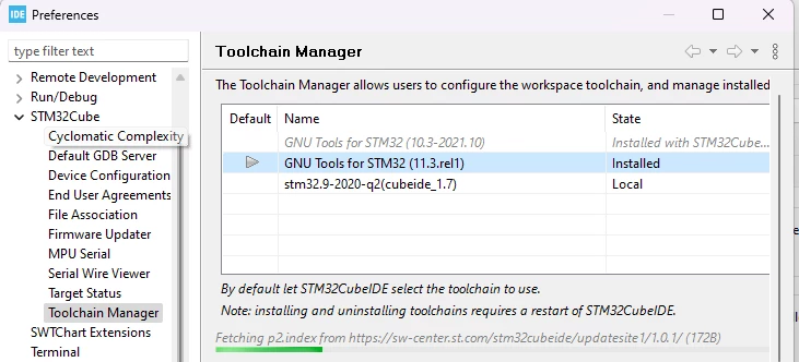

Well, both internal and external builders fail with  same error, so this is objective. Check in the project (or workspace) properties which  toolchain is used. Is an old toolchain selected, which is no longer installed? If so, install this older toolchain (preferred) or try to jump ahead and choose a toolchain that is available.
Try to reinstall CubeIDE (again, the same version that you've used then, is preferred).

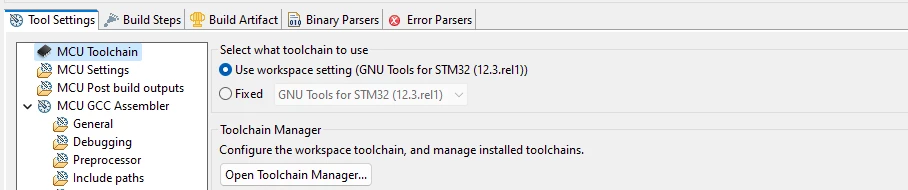

Pavel A.
January 14, 2024
Can you post a screenshot of the toolchain selection in your project?
aelgammalAuthor
January 14, 2024

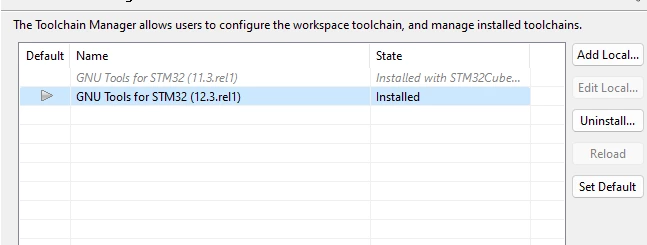

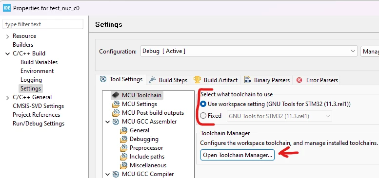

Semer CHERNI
January 15, 2024
Hello @aelgammal
Could you try to make the build using the "GNU Tools for STM32(11.3.rev1) toolchain.
KR,
Semer.
aelgammalAuthor
January 15, 2024
Hi @Semer CHERNI
Thank you for the reply. I  tried that and still getting the same issue.
Regards,
Amro
