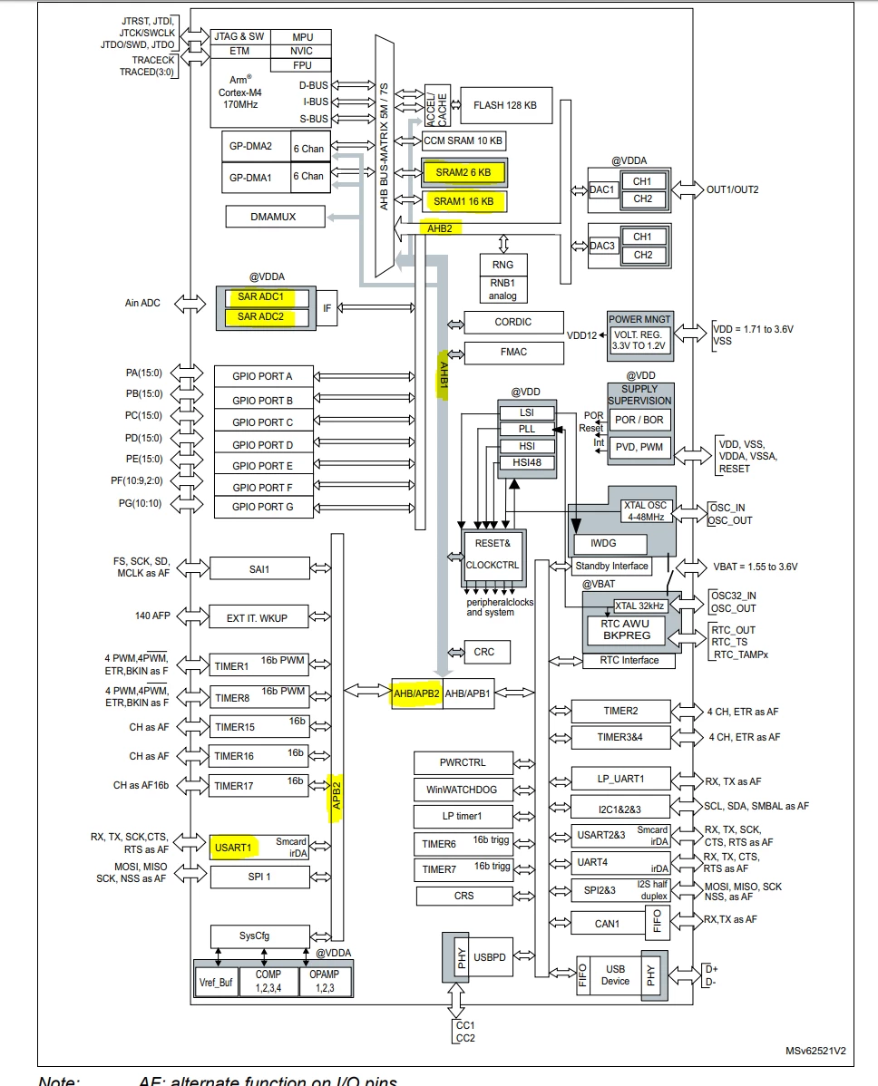

Hi, I was wondering if the two DMA modules can work simultaneously without competing for Bus?
For example:

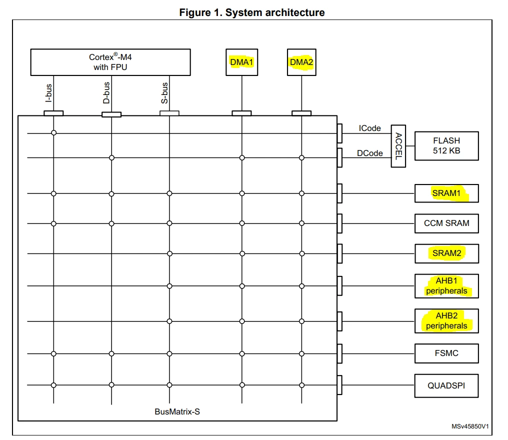

In BusMatrix.png file you can see that both DMA1 and DMA2 are connected SRAM1,SRAM2,AHB1 peripherals and AHB2 peripherals.
So if I set the DMA1 to get data from ADC1(In AHB2 Bus shown in Connections.png) to SRAM2 and set the DMA2 to get data from SRAM1 to USART1(In AHB1 Bus shown in Connections.png) are these two DMAs will compete to be the master of the bus? Or are they going to work simultaneously without disturbing each another?
If so, can this be used when there are no available bandwidth in DMA1 so ADC part can be moved to DMA2 to free up some bandwidth in DMA1?

I understand using more than one dma doesn't slow them down but will the performance increase when utilizing both DMAs with different memory location (SRAM1 and SRAM2) and different AHB busses?

Hi, answer can be YES NO or DEPEND to.
If two DMA use same buses then Arbitration solve priority and usage.
If on different separated buses transfer run parallel.
If transfer is from two different BUS sharing one common source/destination then it depend on timing.

By saying "If on different separated buses transfer run parallel." you mean different Bus in Bus Matrix right? If different Slaves like SRAM1 and SRAM2 is used with DMA1 and DMA2 transfer is happening in parallel right?

So storing my ADC buffer in SRAM2 and USART1 buffer in SRAM1 and assigning different DMAs to control data transfers for these buffers will my DMAs work in parallel thus will increase the performance right (By performance I mean they won't collide with each other thus will have higher bandwidth)? Since ADC1 is in AHB2 and USART1 in AHB1 bus.

Hi, It is not simple answer this, I can answer about my IP CORE how use DMA and why I doubled bus access and parallelism on extreme bandwidth IE video generation/acquisition.
In your case ADC speed with USART too result in a fraction of CPU bandwidth.
Under these condition CPU is the primary bus winner and arbitration ratio (as from RMcCa answer) is not relevant to very few accesses.
In a large M2MDMA CPU lost arbitration cycle by cycle so it slow down. If involved memory area is video or network related, CPU is less important than animation effect or risk of network packet drop. These cases it is better raise DMA priority over CPU bus access.
