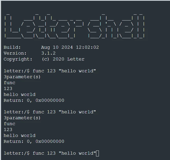

August 12, 2024
Can't work on CubeIDE, but can work on MDK
  • August 12, 2024
  • 6 replies
  • 3118 views
I want to use ThreadX and a Command-Line called letter-shell with CubeIDE, used a uart lib(lwrb) but changed it to HAL, but it will crash when send an costum command. Send string is "func 123 "hello word"".
Here are a few of the ways I've tried:
First, it works well without ThreadX when using CubeIDE, still used a uart lib(lwrb) but changed it to HAL. Here is the repository(link).
Second, I tried porting the program to MDK, everything is same but compiler. The project of CubeIDE and MDK are both in this repository(link).
Third, I increased the heap and stack when using CubeIDE and ThreadX, it does not work.

It's very strange, the question is not letter-shell, because it works well when not using ThreadX. I was bothered by this issue for more than two weeks.

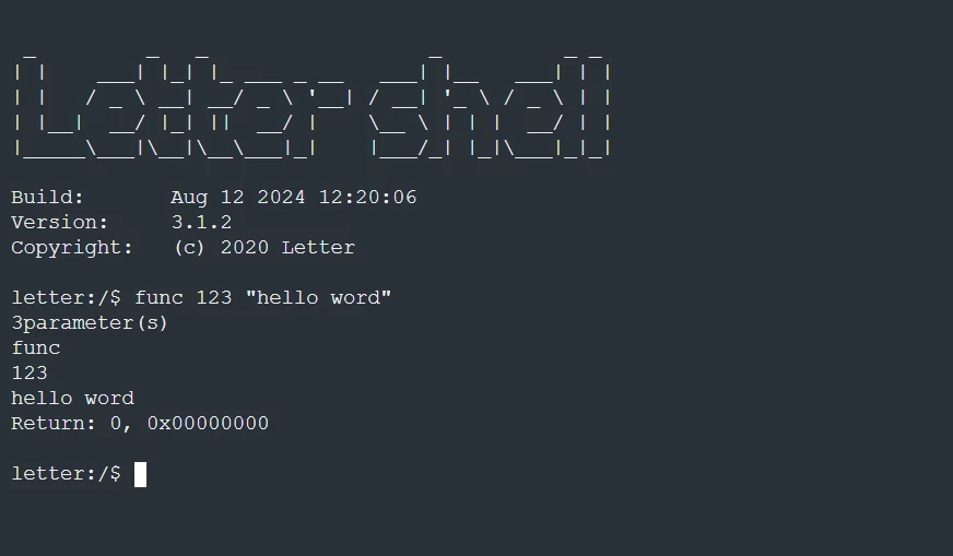

Here's how I debugged:
Break points in the loop of the task, the costume command function, the common execution part of the UART interrupt.
Start project.
Send "func 123 "hello word"" from PC, the ringbuff rx_ringbuf is written correct data.
The letter-shell got the correct data from the ringbuff rx_ringbuf.
The costume command function has been executed, as the first picture see.
However, even the break point in the task still exist, it won't stop. The task can't be executed again.
But UART interrupt still works, it could write correct data into the ringbuff.
I tried to switch UART to SEGGER RTT, it's still the same phenomenon. The command still could be executed just once, then the task will not be executed again.
