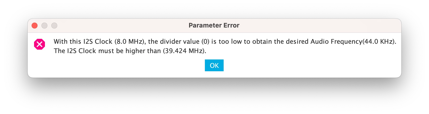

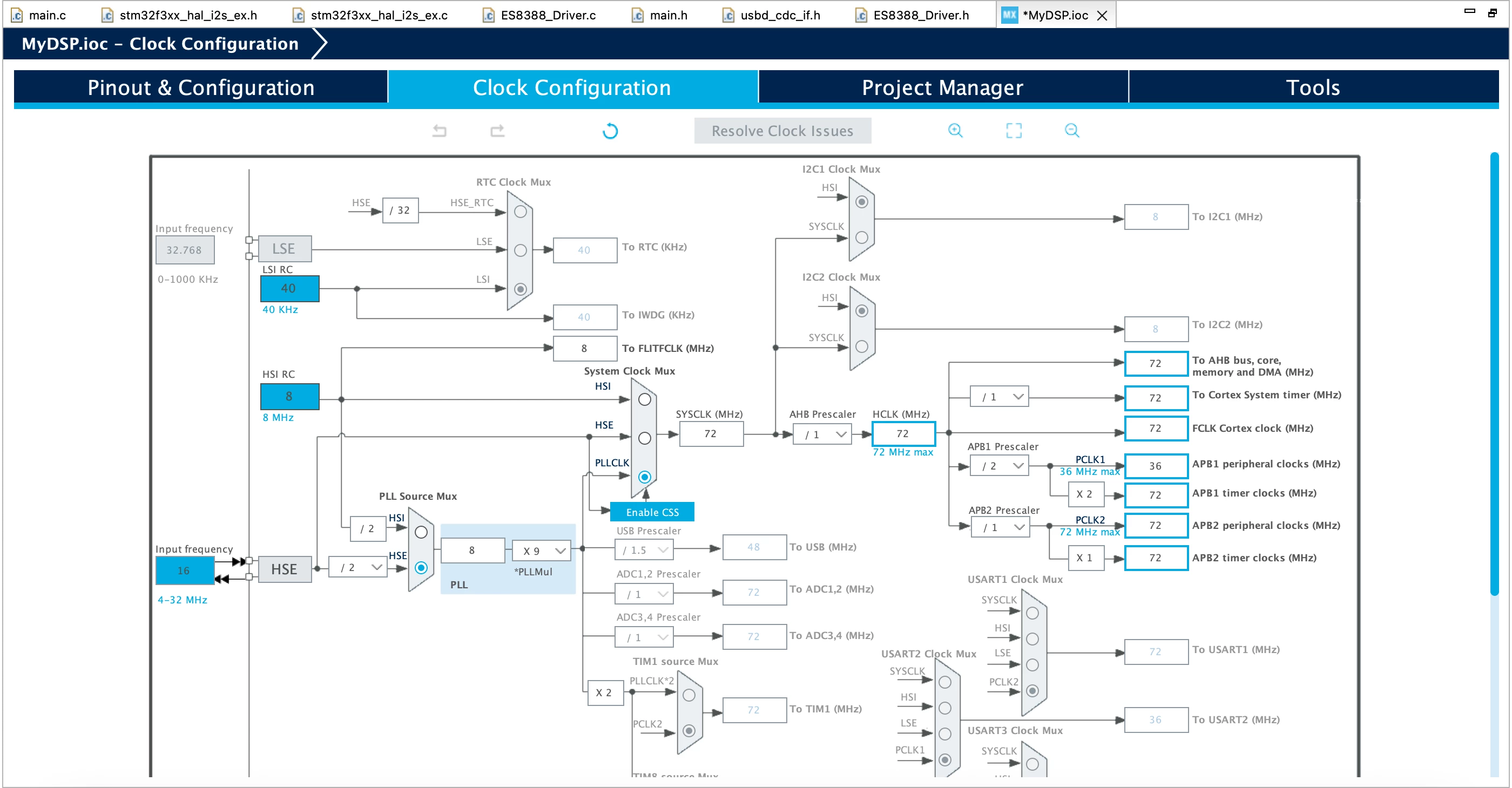

Hi, I'm trying to set up the I2S of STM32F303CBT6. Everything was fine until I checked the box "Master Clock Output", it said "With this I2S Clock (8.0 MHz), the divider value (0) is too low to obtain the desired Audio Frequency(44.0 KHz). The I2S Clock must be higher than (39.424 MHz)", although I had turned on the HSE with PLL, which is 72MHz of system clock. Am I missing something or it's a problem with STM32CubeIDE itself?

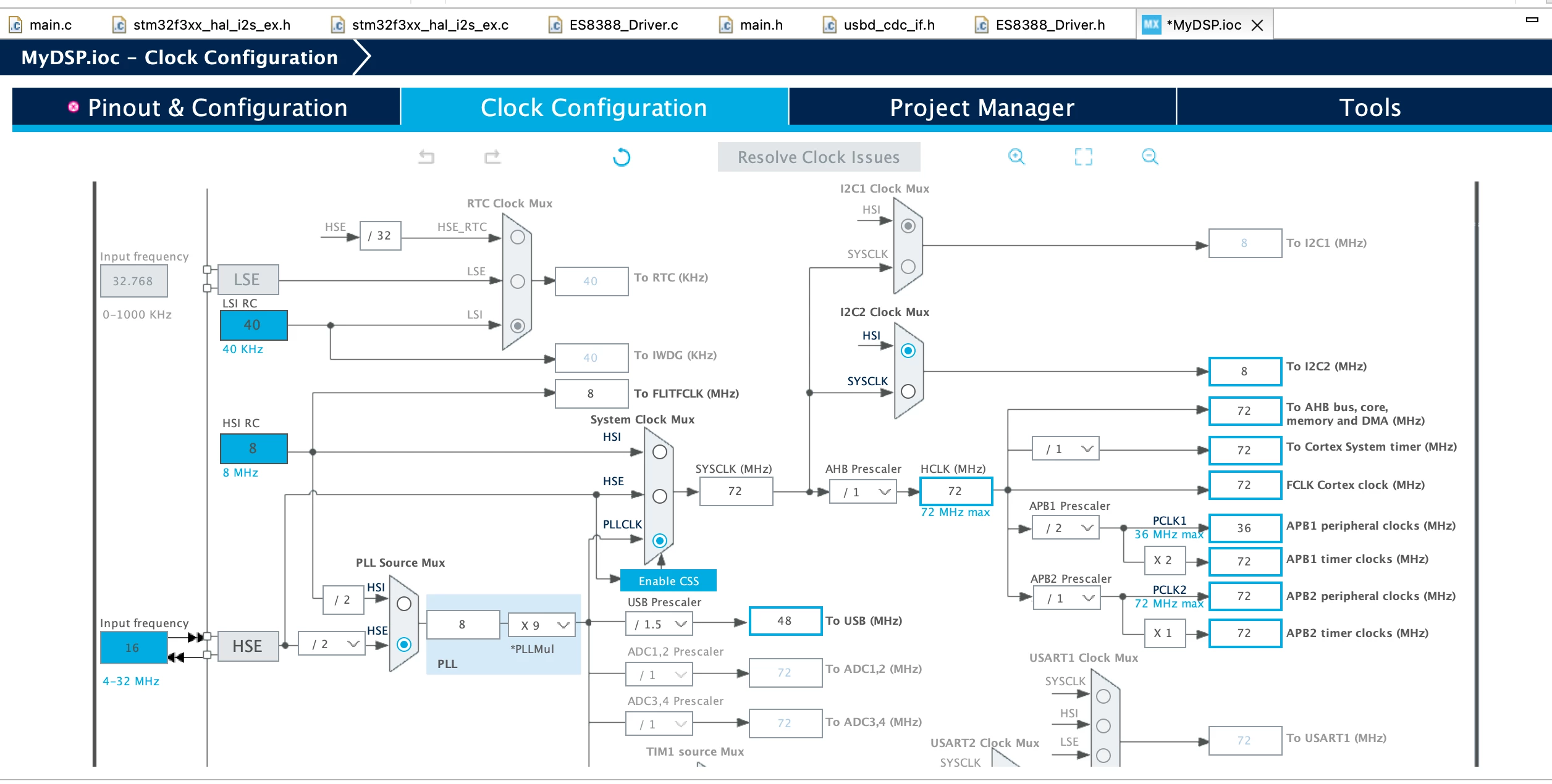

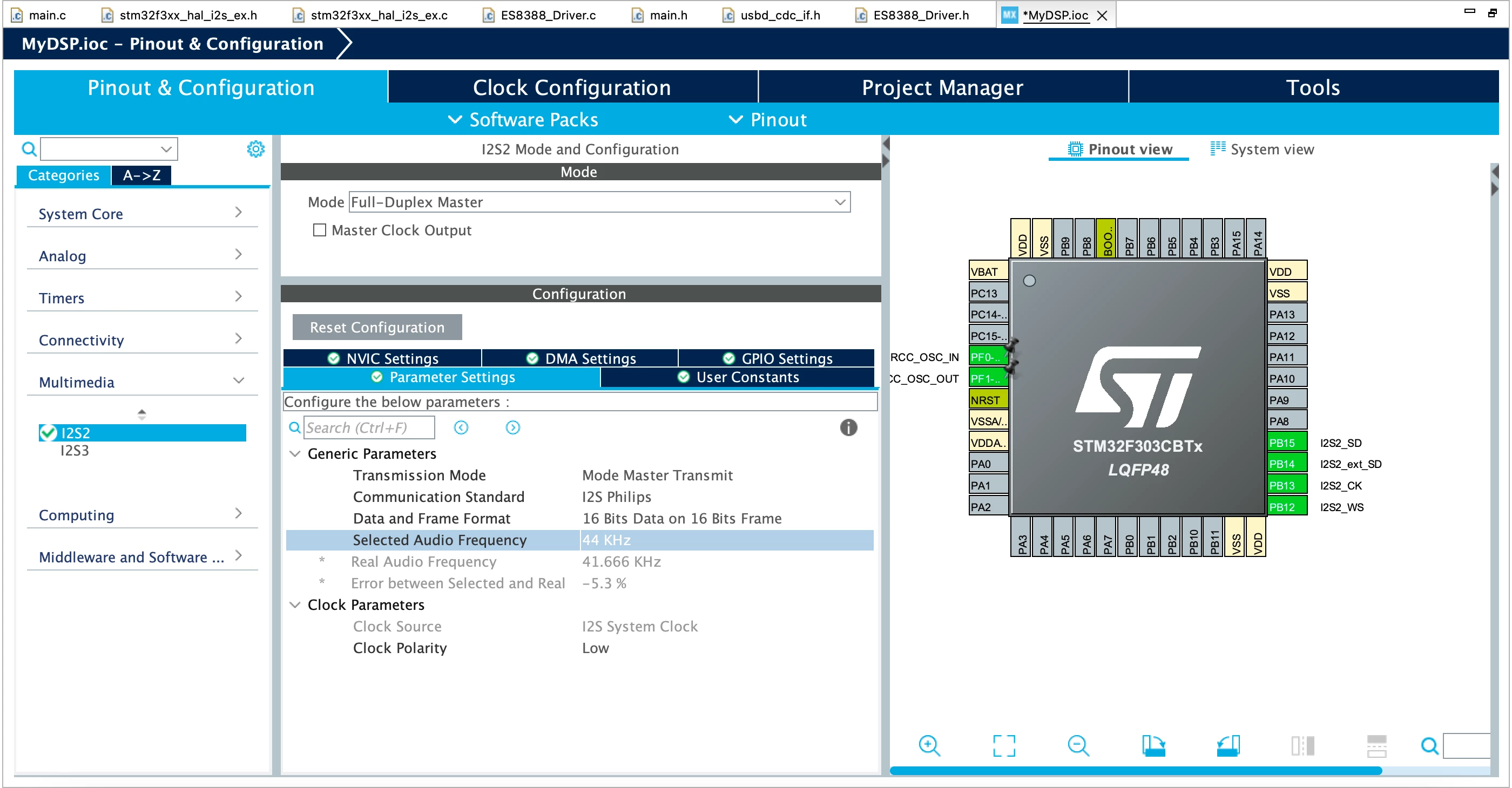

    For some reason, I can't upload my IOC here. In the IOC file, first I set up the HSE PLL clock with 16MHz crystal and 72MHz system clock. Then I set the I2S2 to full-duplex master mode, communication standard is I2S Philip, Data and Frame format is 16 bits data on 16 bits frame, 44KHz audio freq. When turning on Master clock output or changing to 24 bits data on 32-bit frame, I get the error message saying 8MHz is too low.

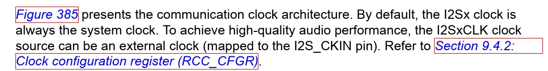

    In 'F3, I2S clock is either System clock or external clock from the I2S_CKIN pin, as set by RCC_CFGR.I2SSRC; the default being the former.
    So, assuming Cube "knows" this, it may try to calculate a divisor from 72MHz which would yield the requested 44.1kHz * 256 = 11.2896MHz for MCO, and fails; however, it incorrectly displays the I2S clock frequency.

    I also think that's a bug. Because I set up the system clock to 72MHz first, then set up the I2S later.

    i just tried same setting, 72M core, I2S on 44k , then activate mck out -> get same error:
    --- but where this 8M clock coming ??

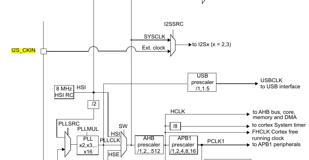

    to put in i2s external clock, >48 pin case is needed...
    PC9 is not here, in 48pin case. so we cannot use/switch to i2s_ckin.
    but internal clock should not be 8M !
    clock tree from ds :
    so I2S clk should come from sysclk (72M) , not be 8M (...HSI RC is 8M ??)
    who is wrong here ?  Cube or datasheet ?

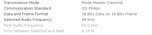

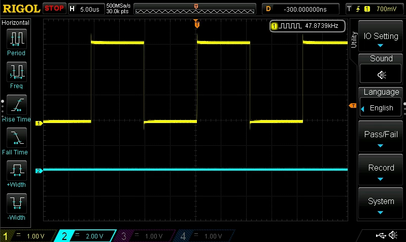

    now i tried with a real F303 , to see what its doing real:
    first set it to I2S , 48khz (wished) , no i2s_mco:
    and 47,873KHz coming out.  :) :)
    (72MHz / 1504 = 47,87234 kHz --- we need @Piranha to find the mathe , how to get "50.0kHz real" here )

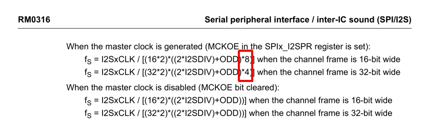

    next: switch on mco (in debug->periph.registers MCKOE called here) -> FS now 5,9842kHz !
    so DIV 1/8 switched in.
    i couldnt find this behavior in manual... the secrets of STM , maybe.
    ed.  Jan found it ... :)
    so its no basic error in Cube, the clock is divided by 8 , as soon as mco on.
    simply said: unusable at > 8kHz and standard audio FS, with audio dacs, that need a master-clk.
    with i2s-mco ON , max FS is 70..kHz.

    waclawek.jan
    November 11, 2023
    As I've said above, if your goal is to have a particular audio frequency, you *start* with selecting an appropriate crystal, rather than trying to fit a integer-multiple-of-1MHz onto the desired audio frequency.
    That CubeMX can't calculate is another thing. Just don't use it.
