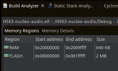

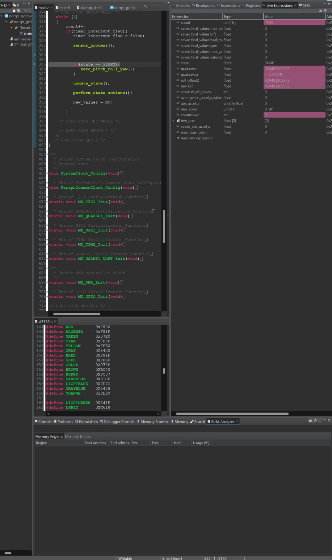

Can't see memory uage at Build Analyzer
Hello!
I have a STM32CubeIDE project that I run on a STM32WB5MMG module.
I program it in debug mode and set a breakpoint in the code.
When I open Build Analyzer it's empty. When I see other people open it, they get information about RAM usage.
What have I missed to not get this information?

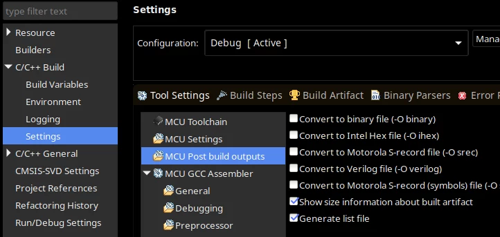

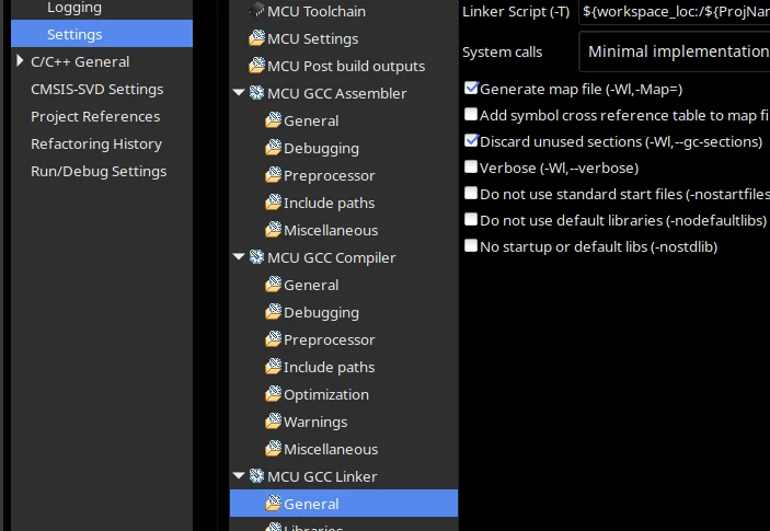

    build analyzer = flash, ram used , you dont see in debug , just after compile you can see it.
    -> for project, you select (= focus is on it)
    see: -> selected project
    then see:
    in settings you must not disable this in project settings:

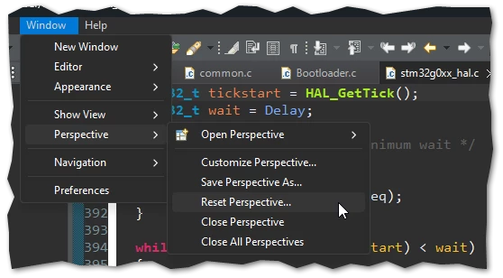

    I have now solved the problem.
    I had to press: [Window]>[Perspective]>[Reset Perspective...]
    This brought back the Build Analyzer
