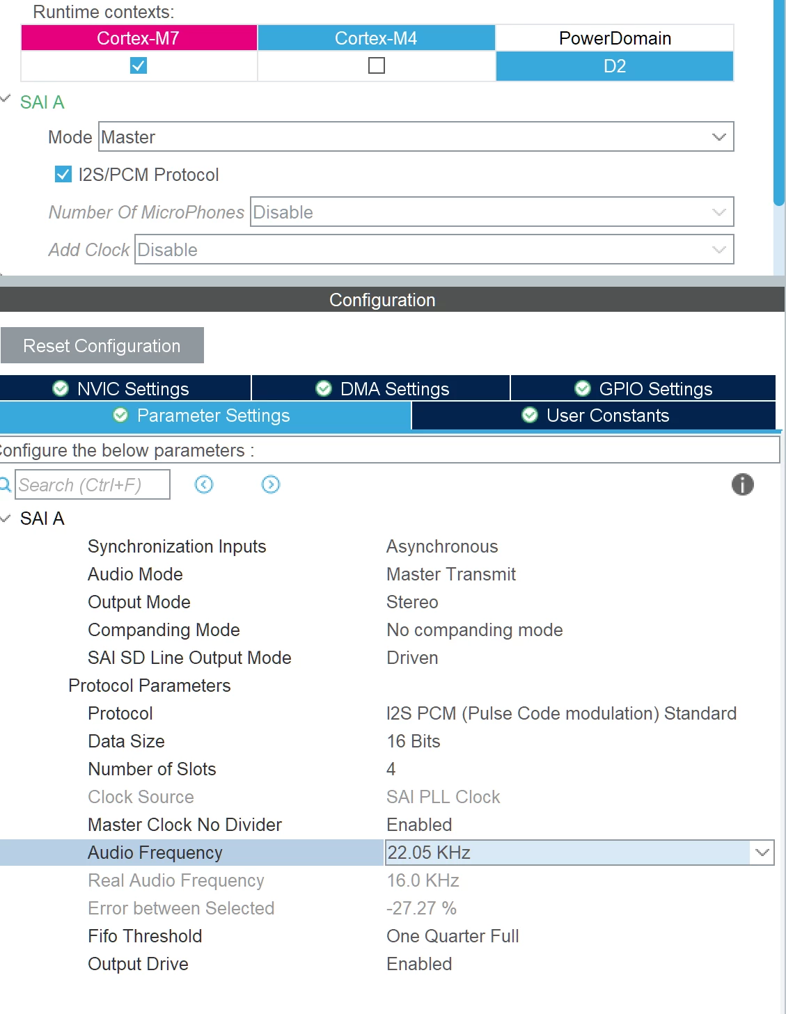

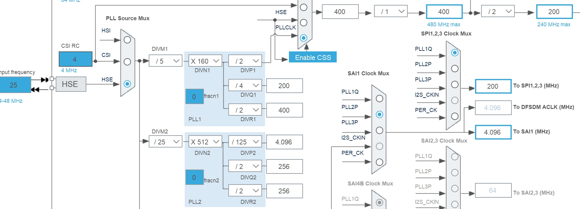

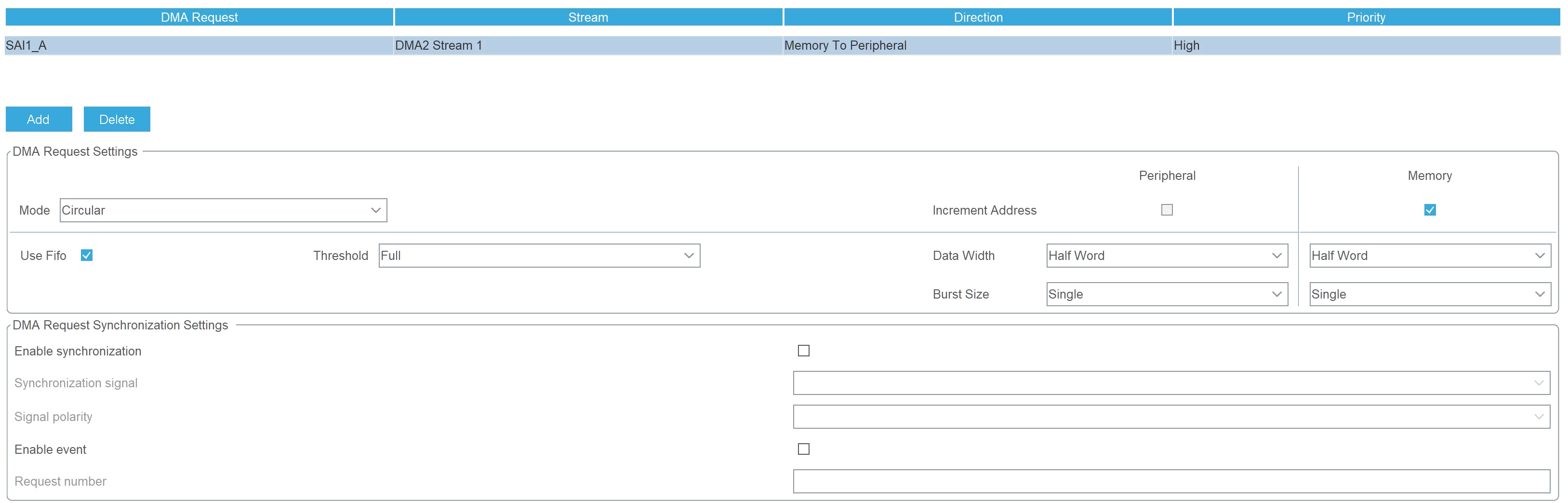

So - the clock for SAI is set to 4.096MHz. I use SAI1 configured as on the screen:
0693W00000WLEAFQA5.png0693W00000WLEAKQA5.png0693W00000WLEAPQA5.pngHere's my code:

What am I doing wrong? My goal is to see a sine wave on one (or best both) speaker outputs. As the WM8994 driver passes initialization, I suspect the SAI doesn't work at all. Or IDK, am I missing something about PCM data? I assumed it's just samples, each 16-bits with sign. But then again, if I messed up the data, but still provided changing values - there should be at least something on the scope. But running the code does absolutely nothing.

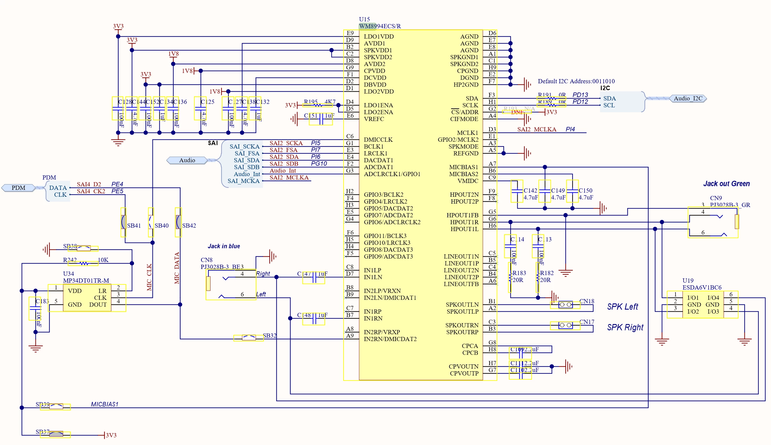

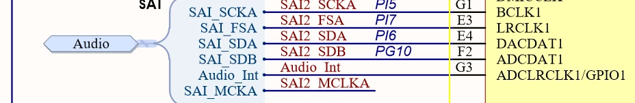

Now wait a minute, I have SAI1 in example, but the board schematics says otherwise:
0693W00000WLEpSQAX.pngI tested it with SAI2, but still, the same, doesn't work.

check the SAI lines with scope , see data ?
+ SAI clock is so slow - why ? ( i use 96 MHz sai module clock )

The lines are not exactly accessible on the board, both MCU and WM8994 are BGA, no wires exposed, no other elements that would have the lines exposed. The clock is from the example, I thought if they tested it with that clock that it should work. I changed the clock to 96MHz, but it didn't help either. I even tried to use HAL_SAI_Transmit() in blocking mode, no DMA, of course it didn't work too.
AScha.3
December 17, 2022
so : sai1 can never "work". :)
on sai2 - clkout A is set ? control the pin numbers, is every pin you use identical with board schematics?

I changed the configuration to SAI2 Block A. Pins match the schematics. Where can I set clkout A?
AScha.3
December 17, 2022
set mode in Cube

From what I see in the board schematics - the WM8994 is connected to SAI2 not SAI1:
0693W00000WLEuNQAX.pngBTW, in the main function of the example you have:

I tried to use the initialization from the example instead of this function, but it didn't help.
AScha.3
December 17, 2022
make new project and try the original example first.
HTD
HTDAuthor
Senior II
December 17, 2022
The original example doesn't show how to use audio on STM32CubeIDE project. The problem is I have big existing project I just need to add a simple beep feature. I've analyzed most of the differences between those two projects and tried to copy everything I could from the original.
My question is how to exactly do beep on STM32H745I-DISCO without starting a new project in Embedded Wizard.
