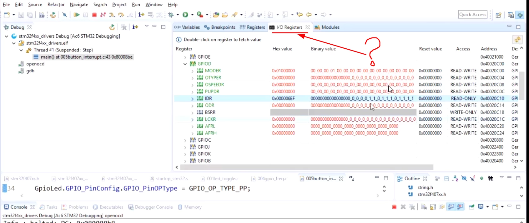

Yesterday I even completely deleted and re-install STM32CUBEIDE and install the newest version from official site, but it did not help me.
Now I have ST-STM32CUBEIDE-1.7.0 and I can't find I/O-Register view in debugging mode.
Could you help me in this question?
I attached a screen,0693W00000Dq19AQAR.png taken from google for understanding what I'm looking for.

Did you try to open that view ? Window->Show view->SFRs.

Does this mean that the "I/O-Register" window do not exist and instead it I need to use SFRS debug window?

I think that SFRs and IO Registers are two names for the same view.

The functionality is similar but, not the same thing!

Are you sure ? I thought that "IO Registers" is name used in SW4STM32, and SFRs is name used in CubeIDE/Atollic for the same function. By the way, is that screen that you've posted from CubeIDE ? Isn't that from SW4STM32 ?
August 23, 2021
"Ac6 STM32 Debugging" would suggest it's SW4STM32, and not STM32CubeIDE. Other icons as well. Help -> About would clear it up. Or the title. Or the icon you use to launch it.
