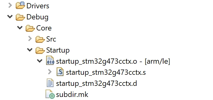

Can't find a source file at .../Core/Startup/startup_stm32g473cctx.s
How do I fix this? when i look into my folders the file is not there

Is this from a created STM32 project inside CubeIDE itself?
What's the path to the workspace? Do you use any non-ascii characters or spaces anywhere?

yes it is created in ide itself. C:\Users\PC-SEVON\Documents\SCHOOL\OneDrive - KU Leuven\stm32\stm32g473. I'm not aware of any non-ascii characters, but the onedrive has two spaces in it's name. but I can see the location in the menu on the left, but not in my folders, and neither can the program

Could also be a "virtual" directory
Do you get the same error if you copy/clone this into a REAL directory on the hard drive ?

Eclipse is not able to build a project correctly if it is installed in a directory where there are spaces in the path.
Try to create a valid workspace path.
