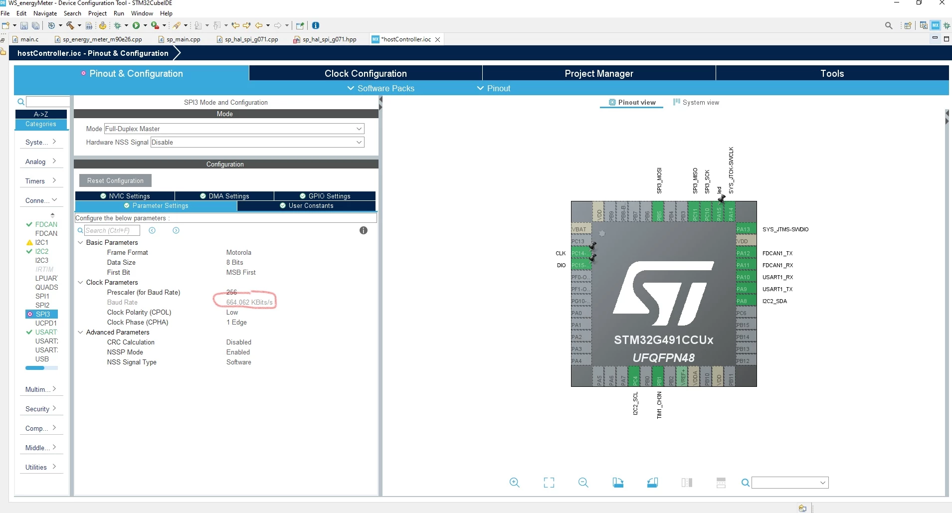

can't decrease SPI baud rate
Hİ, i use energy meter ic name is atm90e26 which communicates over SPI and UART. I prefer SPI in my project. But there is a problem about baud rate. Max baudRate of energymeter is 160k bit. Minimum baudRate of stm32g491 is 664k bit at 170Mhz Clock frequency. When i decrease clock frequency, the baud rate of spi is also decreases but i dont want to decrease clock frequency of  stm32. Added photos about setup and datasheet. İs there any way to solve this problem?

    May be you can try to increase APB1 Prescaler divider in "Clock Configuration".
    Move from /1 to /8...
    Regards.

    yes it is possible but this also decreases other peripherals frequency. I guess there is no choice except this. Thank you.

    You can also try to use some of the USARTs in synchronous mode.
