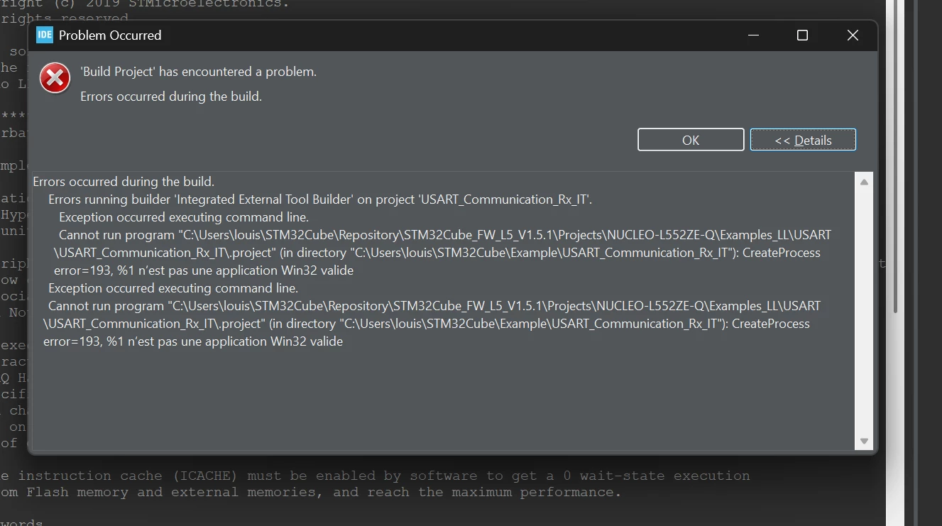

I'm trying to do some work on the stm32 L552ZE-Q and I'm trying to launch some demo projects available but once I've imported the porject in the IDE I can't build the project. I have that error:
and I also got a warning but I don't find why it is here:
And the build button is inaccessible:
Thank you for your help!

Hi Imen,
I've try to import the file via different methods:
  • The copy into workspace
  • Via the import option
  • Via open project in the file system
  • with the project selector of Cube IDE
And every method fail to build the project.
How can I open the projects from the CubeL5 Package ?
Thank you for your help.

I have reinstalled the package cubeL5 and now it's working!
