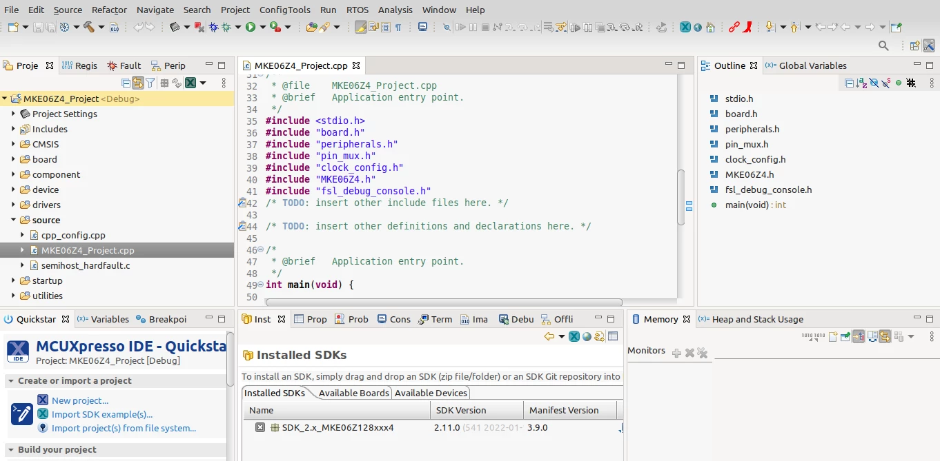

I'm not sure if it's a bug or not but the MCUXpressoIDE works as expected. In this case If you create a C++ project the IDE generates a .cpp main file (MKE06Z4_Project.cpp). This is a natural workflow to me without doing workarounds.
0693W00000KcLyhQAF.pnggaston
