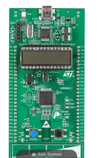

    AScha.3
    June 28, 2023
    so buy a cheap disco board, to make some first programs and see them work (or not :) )
    https://www.mouser.de/ProductDetail/STMicroelectronics/STM32L152C-DISCO?qs=OMTSpu7JCCvskXaoWbf3ow%3D%3D
    12,38 €
