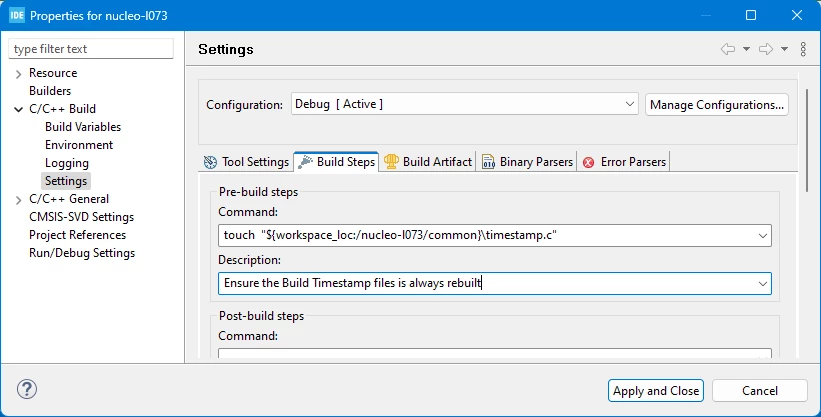

I think that would suffer the same issue as my "timestamp":  ie, the "build number" would get updated every time you press the 'Build' button - whether or not there was anything else in the rest of the project that would have been built?
The 'Pre-build' seems to come before the evaluation of whether there is actually anything that needs building?

I have a timestamp.c file:
/* Public variables ---------------------------------------------------------*/
const char build_date[] = __DATE__;
const char build_time[] = __TIME__;
So those strings can be printed as required - to show when the code was built.
I use this Pre-build step to ensure that the file is always recompiled:
Slight downside with this is that the timestamp file will always be rebuilt - even if no other files have changed.
I haven't found a better way in Eclipse to specify "include in every build" - like other tools have.
