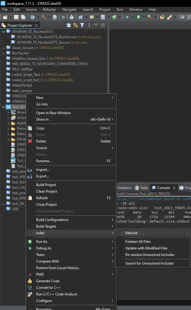

C/C++ Indexer has encountered a problem - 1.11.2
How to fix this error in latest STM32Cube IDE I am getting the attached error.
Regards,
p
2 replies
Semer CHERNI
Feb 27, 2023 3:47 PM UTC
Hello @PVaaz.1​
You can start simply by rebuilding the indexer :
  • Right click on the project
  • Click on Indexer->Rebuild
0693W00000aHlHWQA0.pngIf the first solution doesn't work try to reset the CubeIDE
And if any of the previous solution doesn't work follow these steps:
  • Close the CubeIDE
  • Go to the workspace directory
  • Go to .metadata\.plugins\org.eclipse.cdt.core
  • Delete the *.pdom files
Hope this came to the help.
