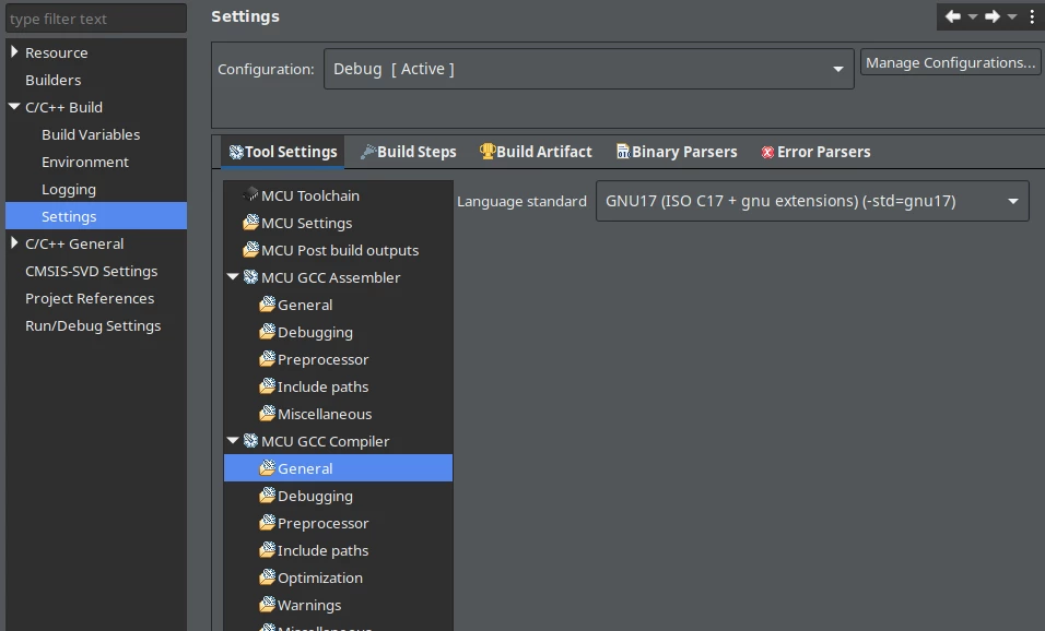

C++20 syntax is not being supported by STM32CubeIDE
I'm writing C++ code wih STM32CubeIDE. Version of IDE is 1.11.0 and it comes with arm-none-eabi-g++ version 10.3-2021.10 . The compiler has some of C++20 features and I'm using them in the code.
The problem is some of them are not recognized by the IDE although the code compiles and runs flawlessly.

AScha.3
January 16, 2023
did you set it in project options ?
(here set C17 )
navidcity
navidcityAuthor
January 16, 2023
Yes I did. It's set on C++20. As I stated, the whole project compiles and runs.
Wijeden RHIMI
January 17, 2023
Hello@ navidcity,
Please put those two information into your consideration :
  • The compiler accepts all C ++20.Syntax.
  • the Issue is related to CDT environment : it is not supporting C + + 20.syntax .
Don't hesitate to ask any more questions.
Wijeden,

Wijeden RHIMI
Wijeden RHIMIBest answer
January 17, 2023
Hi again @navidcity,
More details:
  • In CDT, there is a component that is usually referred to as the “indexer�?.
This component is basically the first part of a compiler, but instead of generating assembler code, it will generate a model that can later be used to lookup function names etc.
  • The indexer has not really got much love in the last x years and thus, has not got the support needed for the recent C++ standards.
Unless someone is stepping in with funding and/or resources, this is likely not going to change anytime soon.
