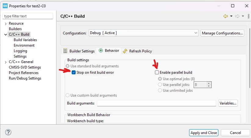

1. please reproduce without the make -j option, to simplify the situation and logs. Will the same command fail again, with the same error?

1. Where should I put the -j option in CubeIDE?
