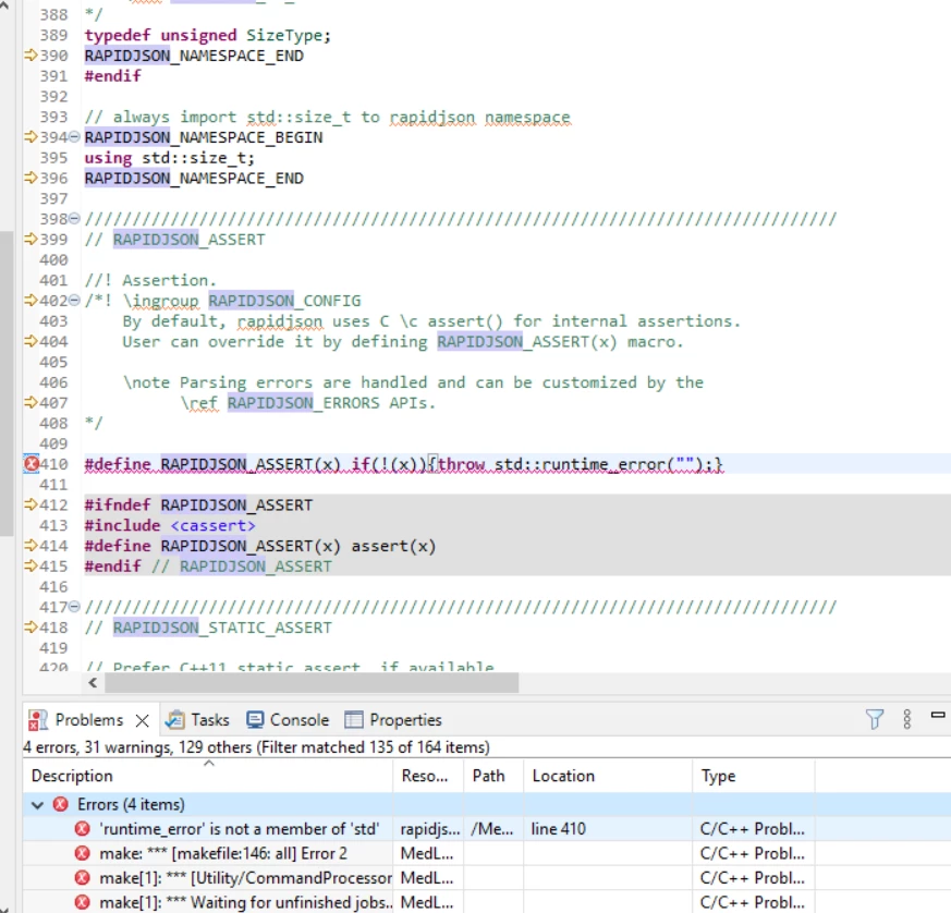

I imported a project (i'm sure it works fine) but i can't build.
Here the errors:
Does anyone can help me?

    runtime_error is defined in <stdexcept>, so include that in the file that uses it.
    #include <stdexcept>
    Note that microcontrollers typically don't use a full C++ implementation and exceptions may not be supported depending on how your project is set up to build (Project Properties -> Tool Settings -> MCU/MPU Settings -> Runtime library). Use the full C++ implementation.

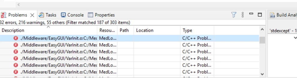

    I solved that problem (thankx) but it isn'Senzaewsdfnome.pngt still ok

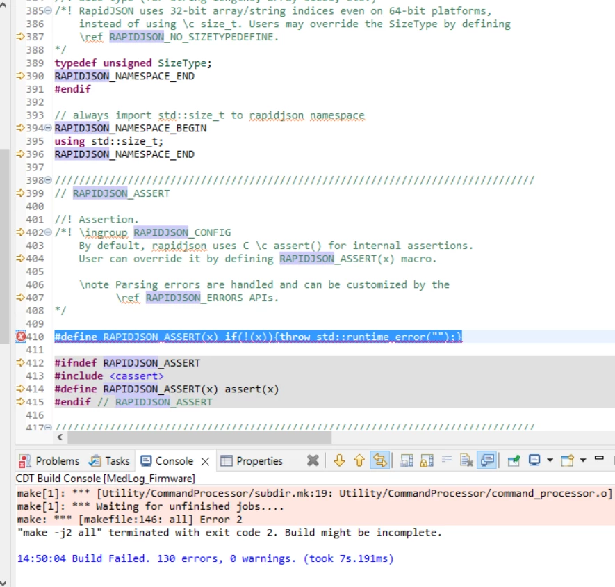

    Your screenshot has cut off any useful error information.
    Instead of the 'Problems' view, the 'Console' is more useful - select all in the 'Console' view, then copy & paste as text here.
