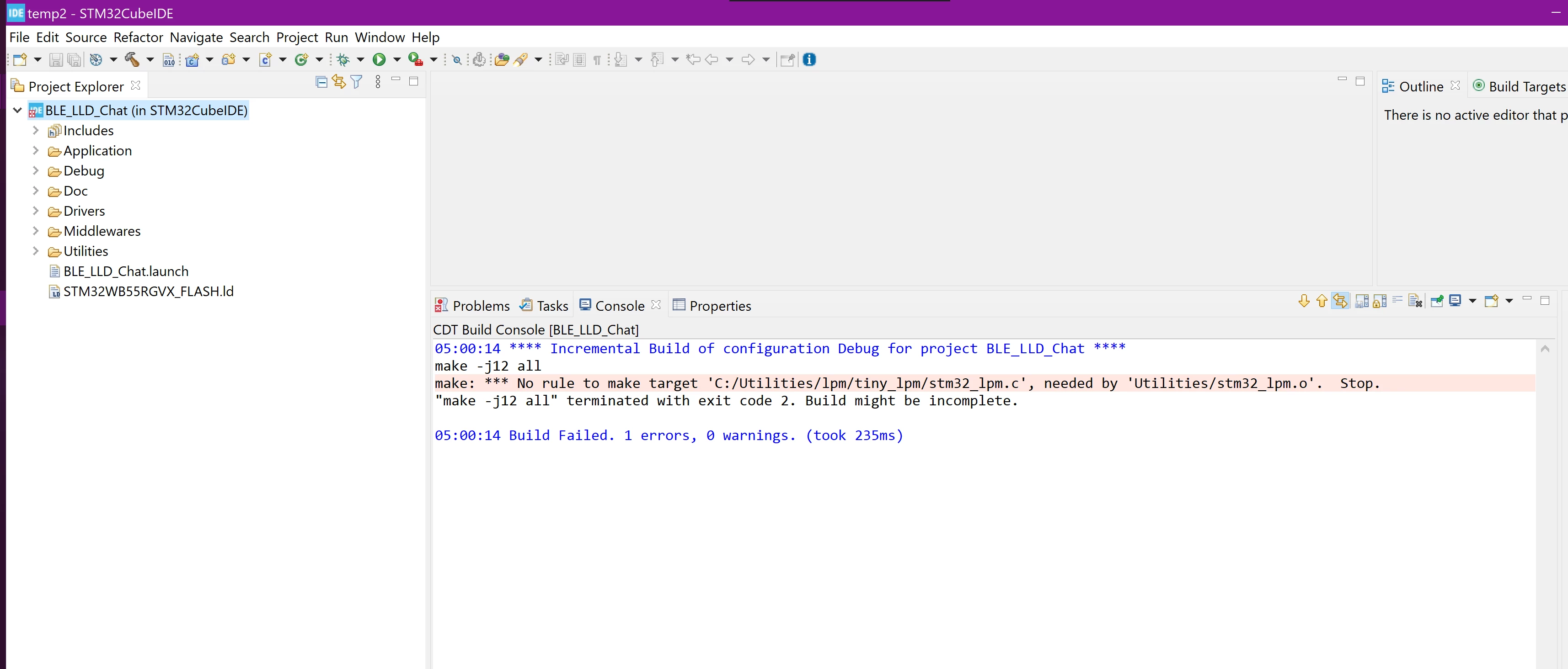

Good morning everyone,
i am having a problem after i copied the example from the example project folder to another location.
i am using STM32CubeIDE 1.5.0. i opened this project
C:\Users\Admin11\STM32Cube\Repository\STM32Cube_FW_WB_V1.16.0\Projects\P-NUCLEO-WB55.Nucleo\Applications\BLE_LLD\BLE_LLD_Chat\STM32CubeIDE
i build it, ran it, without any issue. the board worked correctly as it should. However, when i copied the said folder "STM32CubeIDE" to my desktop to make some changes according to my requirements, i opened a new instance of IDE, chose a different workspace, chose the project on my desktop
C:\Users\Admin11\Desktop\NewFolder\STM32CubeIDE
clicked build, i got this error
how do i fix it? is there any other way to modify the example code according to my own requirnment without changing the original code in the example? or can i change something to get rid of the error?

edit: i tried copied the folder BLE_LLD_Chat instead of STM32CubeIDE. I was hit with another error
06:11:53 **** Build of configuration Debug for project BLE_LLD_Chat ****
make -j12 all
arm-none-eabi-gcc "C:/Users/ADMIN123/Desktop/NewFolder/BLE_LLD_Chat/Core/Src/main.c" -mcpu=cortex-m4 -std=gnu11 -g3 -DDEBUG -DCORE_CM4 -DBLE_LLD_WB -DUSE_HAL_DRIVER -DUSE_STM32WBXX_NUCLEO -DSTM32WB55xx -c -I../../Core/Inc -I../../STM32_WPAN/App -I../../STM32_WPAN/Target -I../../../../../../../Drivers/CMSIS/Device/ST/STM32WBxx/Include -I../../../../../../../Drivers/CMSIS/Include -I../../../../../../../Drivers/BSP/P-NUCLEO-WB55.Nucleo -I../../../../../../../Drivers/STM32WBxx_HAL_Driver/Inc -I../../../../../../../Drivers/STM32WBxx_HAL_Driver/Inc/Legacy -I../../../../../../../Utilities/lpm/tiny_lpm -I../../../../../../../Utilities/sequencer -I../../../../../../../Middlewares/ST/STM32_WPAN -I../../../../../../../Middlewares/ST/STM32_WPAN/ble_lld/hal -I../../../../../../../Middlewares/ST/STM32_WPAN/ble_lld/lld -I../../../../../../../Middlewares/ST/STM32_WPAN/interface/patterns/ble_thread -I../../../../../../../Middlewares/ST/STM32_WPAN/interface/patterns/ble_thread/tl -I../../../../../../../Middlewares/ST/STM32_WPAN/interface/patterns/ble_thread/shci -I../../../../../../../Middlewares/ST/STM32_WPAN/utilities -O0 -ffunction-sections -fdata-sections -Wall -fstack-usage -MMD -MP -MF"Application/User/Core/main.d" -MT"Application/User/Core/main.o" --specs=nano.specs -mfpu=fpv4-sp-d16 -mfloat-abi=hard -mthumb -o "Application/User/Core/main.o"
In file included from ../../Core/Inc/app_common.h:35:0,
from C:/Users/ADMIN123/Desktop/NewFolder/BLE_LLD_Chat/Core/Src/main.c:41:
../../Core/Inc/app_conf.h:25:10: fatal error: hw.h: No such file or directory
#include "hw.h"
compilation terminated.
make: *** [Application/User/Core/subdir.mk:51: Application/User/Core/main.o] Error 1
"make -j12 all" terminated with exit code 2. Build might be incomplete.
06:11:54 Build Failed. 2 errors, 0 warnings. (took 359ms)

You completely missunderstand how repository works. After you understand it , you too understand how and where clone projects...
